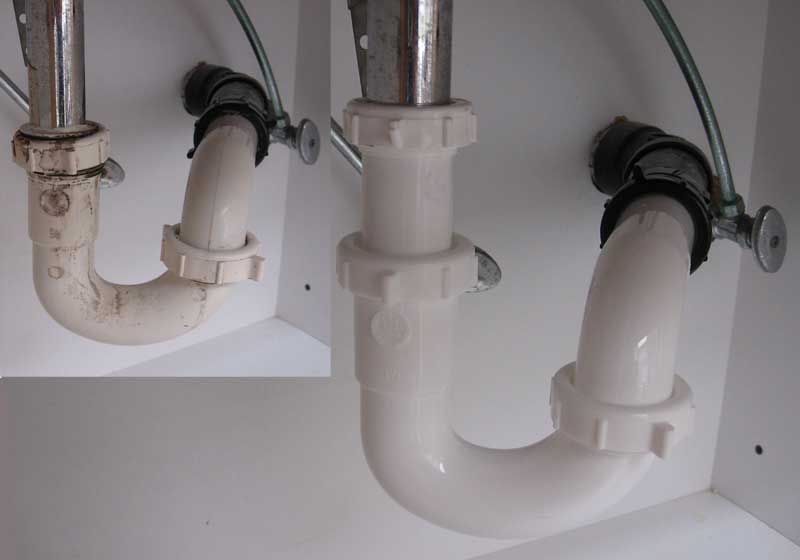

I’m a first time homebuyer with basically no experience and decided to redo a bathroom. The pipe for my new sink isn’t long enough to connect to the existing pipes. Can anyone give me a Home Depot or Lowe’s link to the connector that I need?

The black piece coming from the sink is called a sink drain pipe or tailpiece. Pull that piece off and take it to the store to find a longer one of the correct diameter (1 1/4 vs. 1 1/2) and length (you may have to cut it to length). Or, use an extender.....
https://www.homedepot.com/p/Everbilt-1-1-2-in-x-12-in-Slip-Joint-Tailpiece-C9793A/205154109
https://www.homedepot.com/p/Everbil...ne-Tailpiece-Extension-Tube-C9790BG/205153709
