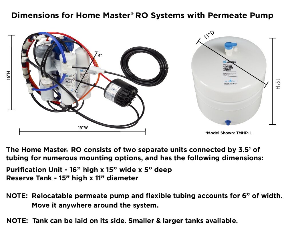

I am replacing a under the counter system that simply did not work.
I have just ordered a new and more extensive under counter unit. But it is not clear that the As is resolved. So I now have two systems that do not seem to filter As 3 and 5.
