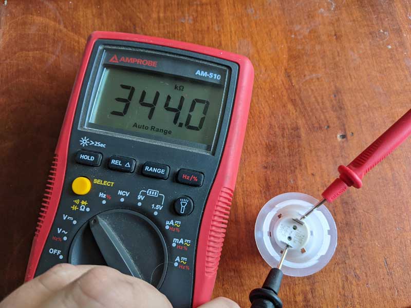

I recently got my mum off a predatory water heater rental contract and set up with a brand new Rheem power vent model. Literally a month later she has no hot water and it's displaying the 7 flash FVS error code discussed in so many older threads on the forum. I've tried the reset procedure many times and it didn't work. I made another trip over there to measure the resistance of the sensor, which is way off at 350kΩ.
According to Rheem, the FVS can literally be set off by dust and humidity, and they won't replace it under warranty. She lives in an old house with a damp and dusty basement that gets a bit of water during heavy rain, but this sensor was never wet or exposed to any kind of flammable vapour. It feels like it will just be a monthly $50 replacement if that's all it took to permanently set off the sensor. Is it even worth replacing it, or should I just bypass it with a resistor?

Since he has a ohm meter and knows how to use it without having the info for the sensor it's a guess that it bad. Knowing that its showing 344k ohms and anything over 45 ohms is bad.

I ended up just ordering a 30kΩ chassis mount resistor which fit the spade connectors for the sensor perfectly, so it's permanently bypassed now. Knowing the environment in the basement, I'd be replacing that part on a regular basis, and it's not worth the time and expense.
