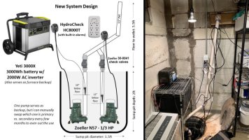

Hi all,
After some recent misadventures caused by an aging sump pump system, I'm planning to replace our current setup with a "spare no expense" system to hopefully last 5-10 years of worry-free pumping.
Attached is a diagram of the planned system, with a photo of the location and current setup for context. I’d appreciate any feedback you all have, and am particularly interested in two questions:
1. Will 1/3 HP pumps be sufficient?
The current pump is 3/4 HP, which seems like overkill. During the wet season, it runs for ~10 seconds every ~15 minutes. I estimate that it is pumping about 50 gallons per hour. The total vertical from bottom of the sump pit to street level where the outlet is located and gravity takes over is ~7.5ft. The horizontal run outside the house is about another 8-10ft.
2. Should I install a catch valve?
I have read mixed reviews of these. On the one hand, they prevent some water from draining back into the pit, which means less work for the pump and a longer lifespan. On the other hand, they can be another point of failure, particularly when the pump sits idle for part of the year (true in my case). Given my 1.5in PVC and a 7.5ft run, it seems like my setup might drop 2.75 gallons back into the pit each cycle, meaning about ~20-25% more work for the pump, but not sure if my math is right.

Do install check valve on each pump. Read instructions for whatever particular equipment as to drilled hole or factory hole below the check valve.
Do get a Duplex system control to alternate the pump's operation, and maybe add a high water alarm, which is just another float switch connected to a noisemaker or a text notifier system.
Use the chart for whatever pump you want, but off the top of my head, any good brand of sump pump like Meyers or Liberty ought to do the trick

Thanks very much for the quick reply and helpful feedback!

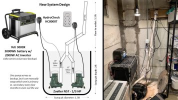

I've generally heard that it's helpful to have the check valves above the sump pit so that it's easier to service them. I'll try to do that here, and have updated the diagram accordingly.
I was planning to use electronic float switches with built-in alarms. By placing one higher than another, it should sound an alarm that the primary pump has failed, while still allowing the secondary pump to function.
I was initially interested in a duplex system, but it seems like it would add a lot of complexity. Instead, my thinking was to simply run one pump for a few months, then the other pump. Do you think a duplex system would provide a big advantage over that approach?

the hydrocheck switches are the best. I have the dual probe version where you can precisely set both turn on and turn off levels, but the single probe should be fine too. mine has been in service for at least 6 years, probably 500,000+ cycles.
i've had Zoeller pumps, but I prefer StormPro. the 1/3hp BA33 is plenty for your water load if that's truly all you get. especially if you have 2 pumps. https://www.sumppumpsdirect.com/iON-Products-BA-33-Sump-Pump/p8195.html
I also have a Menards Barracuda 3/4hp in and outdoor sump application to pump away standing water in the backyard, and it stays out all winter. the whole thing freezes solid every winter, and 7yrs later its still pumping like a champ. at $145 with the 11% rebate its probably the best deal you will find in sump pumps. build quality is similar to storm pro. you can tie up the switch and use it with your hyrdocheck if you want. (actually you don't need to tie it up like a zoeller float since the pump has its own power cord). Barracuda 3/4hp pump
running them through that Yeti is a good idea in theory, just be careful. you may want to keep one pump plugged directly into house power in case the Yeti shuts down for some reason when you're not home. I've had that happen with similar backup power systems (Tripp Lite APS2012) the dang thing would randomly shut itself down for no apparent reason even when house power was still live, and when it did it would cut off power to the pump. total fail. so I have my own homemade auto transfer switches now that will always deliver house power to the pump no matter whats going on with the inverter or batteries.

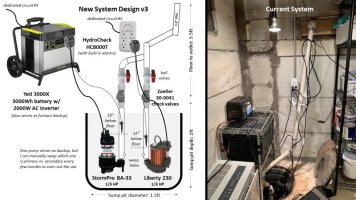

Hi all,
Thanks very much for the feedback! I've updated the system diagram based on your input.
@breplum - thanks for the advice on check valves and weep holes. Based on some further reading, I also added ball valves above each check valve to make it easier to remove the check valves or pumps for maintenance without making a mess.
@gagecalman - interesting idea about the water powered pumps. I did consider that, but not in detail. Since I need a backup battery for the furnace anyway, I figured a second electric pump might be simpler to install and maintain.
Thank you both @gagecalman and @skyjumper for the feedback on pump brands. Based on that, I'm thinking about going with one Liberty pump, and one StormPro pump, each on a dedicated breaker. Since I'm planning to run them both about equally (by switching which one is primary vs. backup every few months) this could be an interesting comparison test.
For the float switch, I was planning to use this: https://www.hydrocheckproducts.com/product-page/hc8000t-sump-pump-controller-float-switch. It looks similar to the dual probe version, but uses a programmable timer instead of a second probe to stop the pump. Seems like a little more effort upfront to calibrate, but then one less wire and one less sensor to potentially fail.
