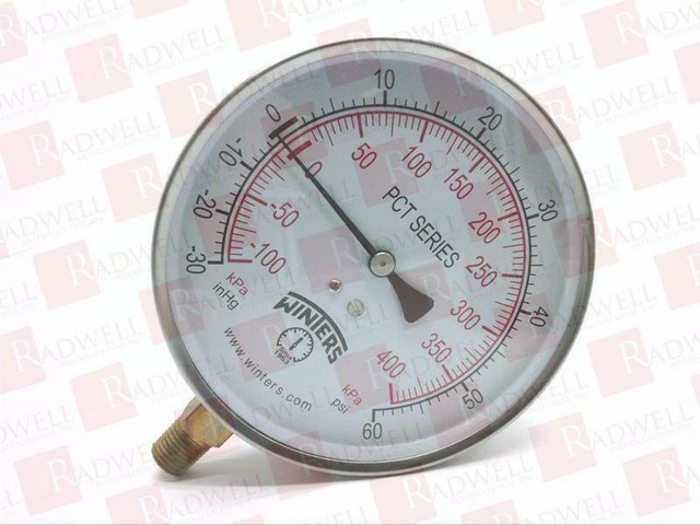

A combination vacuum/pressure gauge at the pump input would be interesting. Adding one adds more places for a potential leak, but it would really make diagnosis easier.
Example: https://www.supplyhouse.com/Winters...2-PCT-Contractor-Pressure-Gauge-30Hg-0-60-PSI has the right part number but the wrong picture.
