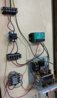

I use a 3 hp deep pump strictly for filling a pond used for irrigation. The pond level is controlled by a Ametek 1500-G-L2-S7 liquid controller. It has always been used to stop and start a 24v sprinkler valve. Due to much maintenance I disconnected the pressure tank, pressure switch, and electric valve and now pump straight to the pond. I now use a 24/240 volt contactor. It works fine using the 24 DC transformer. The problem is when you install the Ametek controller between the transformer and the contactor, the contactor chatters, and stops and starts rapidly. Nothing is loose and all connections are tight. Could the contactor be too strong, although it works fine from the 24v trans?

I found the data sheet. Nicely written. Where is this 24vac coil side contractor connected to? Is it on terminals 1 & 2? Can you provide a basic siring diagram? while it is chattering, can you get a voltage reading of the 24's? The contacts for 1& 2 may be worn causing high resistance and dropping the voltage. 24v relays will usually work between 18-29 volts. A solenoid coil is more forgiving. As a test, during the chatter, short the terminals on the level controller to bypass the contacts.

300 ma = .3 amp Thats your problem contactor has 30 va in rush 1.25 amps . Transformer 40va 120vac to 24 vac is what you need.
Va is 40 ÷ 24 = 1.6 amps
In rush amps what it takes to pull the coil in , not to hold it in

Thank you for the reply. Nothing is wired to 1-2. 3-4 is connected to the switch on the pump control box. 5 has one wire from the transformer and 6 going to one side of the contactor. 8-9-10 goes to the pond. 7 has a jumper to 9.

Thank you. I will be back Monday and get that installed.
