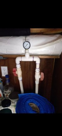

Grabbing at straws...before I must get a new well drilled.
How long might it take to prime an above water well pump? (SE Florida, well about at 18 feet (guessing))
Is the upper shut off valve good enough or priming the pump? see picture (The next option is the hose for filling up the washing machine...or a faucet in the trailer about 40 feet away)
New tank, new motor, new plumbing - tank gauge is not moving from "0" at all after running the pump for about one minute.
(Old motor with new tank was working but pump didn't shut. Tank reached only 54psi. After replacing 40/60 to a 30/50 switch no changes. Turned motor off by throwing the power switch. Worked for 1/2 day...than no water at all. We cannot locate the well....pipe from motor runs in the opposite direction of where the well should be - according to old plans.)

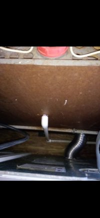

New tank is in a shed, close to the pump. Second pic shows pipe coming in from the pump, first pic shows pipe above tank.
Pipe coming into the Shad was originally low to to ground- same hight than pump. Pipe was raised about 3 feet inside the shed for easier access. All done when issue started.
My ex+handyman is ready to contract a well driller,saying the well is dry...I've no clue but I'm reading up on it online..and would like to try anything before paying for a new well. (And I really don't want to dig the trench for a new pipe. - I was digging all day trying to find the well...).
any input/ ideas are welcome!

Are you shutting off the priming valve before starting the pump?

Priming valve ( the bottom one in the picture) left a little open for air getting out Should it be totally shut?
