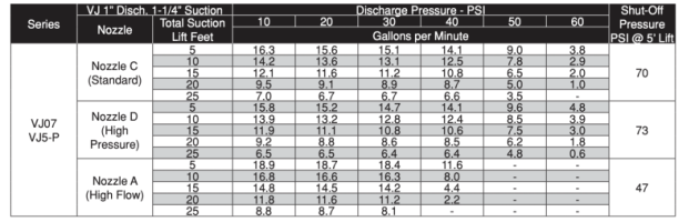

- I will initially be running just well pump and pressure tank. Then eventually install and transition to a surface storage tank with surface jet pump. The surface storage tank will be filled around every 10 days with well pump and float valve. If I get a CSV, I want it to be used for well pump and then be able to adjust it for jet pump when it goes into use and not have to move the CSV so I can switch back to direct well supply if needed. So from my diagram below, where should I put the CSV for that?
- I'm looking at the Franklin 3/4 VersaJet pump. The specs are below. Its output psi is much less than well pump. It would be nice to have a more constant pressure in system and less cycling for jet pump, but will CSV be able to do that since it cant output much more than 60psi anyway? Do I need a larger jet pump? I'm planning to set system 40/60 due to long run.
Well pipe is rated for much more than 200 PSI. Just install the CSV1A as close to the well head as possible with no valves of any kind prior to the CSV, except for the check valve down on the submersible pump. Only the well pipe prior to the CSV will see the 179 PSI, as everything after the CSV will see no more than the pressure switch cut off pressure of 70 PSI.
Very few people understand the mechanics of why a pump works easier and uses less amps as the flow is restricted with a valve or the pump is installed deeper in the well. It is why so many people fall for a VFD or variable speed pump as they think the RPM's must be reduced for the pump/motor to work easier and use less energy. The curve I posted above is at FULL SPEED, and the amps decrease with the flow rate and increase with lower pressure or head. It is counter intuitive and what keeps me in business. If everyone understood a pumps amps drop when running at full speed by just using a valve, I would have tons of competition. As it is hard to understand, I only get the intelligent customers. :)
The same CSV1A or PK1A kit will work with the jet pump, then can be moved to control the submersible well pump when needed. Of course you can do both, like the drawing in post #3. That submersible will build as much pressure as you want, so you can set the CSV to hold a constant 60 PSI and use a 50/70 pressure switch. However, that jet pump, even with one of the first two nozzles, only builds a max of 70 PSI. That means the CSV would need to be adjusted to 50 PSI and use no more than 40/60 setting for the pressure switch.
