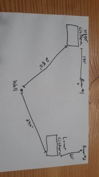

Hello all,
We currently have two cabins separated by about 400'. Each cabin has a 2500 gallon cistern that it is plumbed to. We have been getting by for 5 years hauling water and filling cisterns after we drilled a dry well. This past fall we dug a new low-producing well (1.5 gpm) that is about midway between the two cisterns. Each cistern has a float switch, but I can't seem to figure out the best way to fill them both with one well. Can somebody help me figure out our best option here? If it's helpful, one cistern is 40' vertical above the other.
Thanks for your time,
Nate

Yes a "trough valve" will work. Any type of float valve will work, but non-modulating is best. I use a float switch to operate a 24V electric "sprinkler" valve at each cistern.
Now to make a float valve or electric valve work, the pump will need to be controlled by a pressure tank and pressure switch and filling multiple tanks as different flow rates is greatly enhanced by controlling the well pump with a Cycle Stop Valve or CSV. A CSV would eliminate pump cycling when only one cistern is being filled at a time.
The well pump can either be restricted to 1.5 GPM or just use a Cycle Sensor and let the well pump run on and off according to the level in the well until both cisterns are full.

Thanks for the replies. Everything here makes sense, but I have a couple of extra questions. We plan to pump from the well to a pressure tank under the lower elevation cabin. From there, water line will feed each cistern separately. The upper cistern from there is about a 400' horizontal and 40' vertical (up) run for the water line from the pressure tank. With 1" line, will we have enough pressure, or will we need a jet pump? The pressure tank also has to be skinny to fit into the crawlspace- less than about 18" wide. Do we need to think of anything size-wise there other than small enough to fit?

40' vertical only takes 17 PSI. Your normal 40/60 switch will be enough to supply the cistern without an additional pump.
Yes, size for placement should not even be a concern for a pressure tank. The tank needs to be as large as possible to reduce the cycling unless you control the pump with a Cycle Stop Valve. With a CSV the tank is almost a moot point however. So, with a CSV a little 4.5 or 10 gallon tank is all you need, and I believe both of those are 18".
