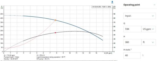

I'm trying understand how we can be overdrawing the pump. The Grundfos is rated at 10gpm but I realize that the flow rate varies as to the head. Still, if I am running out water at 4gpm or less, why is the pump not being able to keep up? Is it because at 380' the pump is actually pumping out at less than 4gpm? If I'm reading this flow chart correctly then at 380' the Grundfos should be pumping at almost 8gpm. I know I'm not running of water from a single faucet at anywhere near that rate.
Are there any other brands of pressure switches available that have adjustable low pressure shut off?

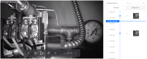

I put a camera on my pressure switch and gauge to record when and how low the pressure drops. My iron filter backwash starts at 2:00 AM and 24 minutes in, the pressure had dropped 10 PSI below cut-in. If I had not lobotomized the low cut-off, it would have tripped.
Pump runs on a curve. 10 GPM at 333 feet of head. Don't forget to add the PSI at the tank as feet to the overall head number.
My Grundfos is 10 GPM but the micronizer constriction increases the head to less than that.

When my well is full I should have 340' of head, which means it should pump 10gpm.

Although your pump is located 380' down into the well, with 40' static level in the well, the pump will only need to lift water from 40', not 380'. When the well's recovery rate (ie: 2 GPM) is less than the rate that water is being pumped out from the well, then the static level will become lower and so the pump will need to lift water from a greater depth and so the pump's delivery rate will become less.
Further to LL's chart, when your pump is lifting water from 40', with 40 psi cut-in pressure, the amount of head will be equal to 40' + 92.3' (40 psi X 2.30725) = 132.3' of head, and 178.45' when pressure is increasing to the 60 psi needed to shut off the pump.
When your water static level has dropped to 200', then that will be 200' + 92.3' = 292.3' @ 40 psi, and 338.45' of head to achieve 60 psi.

If you do pull the water level down to 380', that pump will only be able to supply about 21 PSI at zero flow rate. I think that is low enough to trip off the low pressure switch. At 2-3 GPM the pressure would be even lower.
