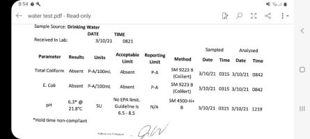

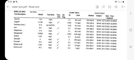

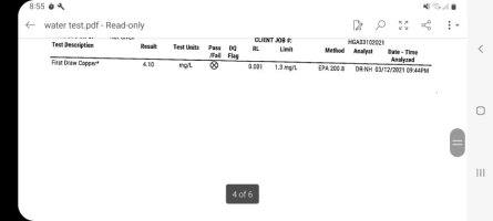

Since you had basically soft water, you should have considered a pH neutralizer using soda ash and polyphosphate... still a viable option. Can you post a real water test so we can evaluate it?

I measured the backwash flow through the drain line at ~2.66 gpm. I have the filter set to backwash once a month and there never seems to be any reduction in water pressure at the faucets or shower. There is no gravel bed in the AN. Is that something required with downflow systems? I attached the water test I had done before adding the AN. Also, the screen in the AN for the water outlet is:
