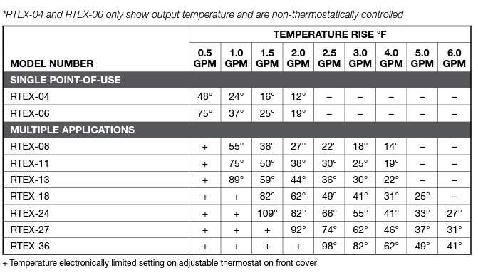

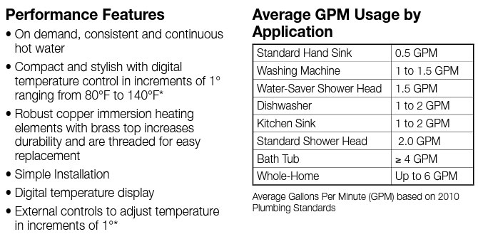

If you have natural gas now for heating water, then a new panel would be needed to go tankless electric. Typically you might be able to supply one bathroom with electric. In the Winter you're pulling water out of the ground at 40.8 F
You need a 79 degree rise in temperature to get up to 120.
The Rheem RTEX-36 would give you about 3 gallons a minute in Winter.
