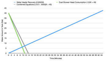

Correct me if I'm wrong, but laying it out here, I've done the math... And it's pretty obvious that the water heater simply can't keep up. :confused:
At 39.32 Gal/Hr recovery rate (= 0.6553 Gal/min), I graphed the depletion of the water heater starting at a full 40 Gallons (see attached).
The blue line is the recovery rate of the tank.
The green line is how quickly the shower heads would drain the water, starting at 40 gal.
The gray line is the combined efforts of the tank and the shower heads.
And voila! At roughly 15 minutes, I'm completely out of hot water.
Does this seem reasonable to you guys?

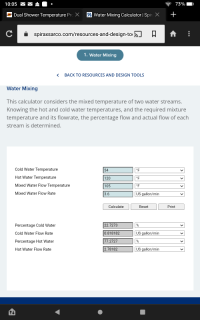

Here's a water temp calculator just change setting
Sample 35 gallons of hot 13 minutesView attachment 93124
Ahhh thanks for this. I’ll rethink my math. Totally was forgetting that the valves are mixing in cold water.
My math assumed they were outputting 100% hot.
