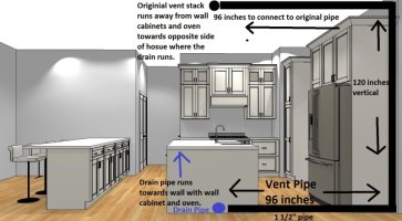

I wanted to add an additional diagram to ensure everything is done correctly. The vent pipe runs 8ft away from drain pipe until it turns 90 degrees and becomes vertical. It then turns another 90 and runs horizontal to the original pipe which turn 90 degrees again towards the vent stack. Its practically right over top the drain and where the vent started. This is the only option if I build a loop vent. The drain pipe is 2 inch and vent pipe is 1 1/2. I have found conflicting information on distance and pipe width. so I just wanted to confirm if this would work.

On the loop vent, the lengths noted on your diagram are not a problem.
The horizontal below floor vent is called the foot vent. The the main requirements are (a) that the foot vent be sloped towards a connection to a drain and (b) that the foot vent be roddable (snakeable). For (a) typically the drain is the horizontal sink drain, which means the foot vent is higher than the horizontal sink drain and rises as it moves away from the island. For (b), typically a cleanout is installed in the vertical vent in the wall.
On the AAV if you use one under the sink (at least 4" above the trap arm), then the whole loop vent goes away. It's that simple, and you just have the drain to deal with as usual.
