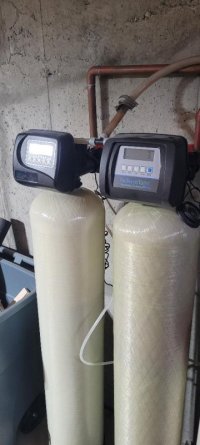

Send a picture of your system so we can assist. Also need the make of the tank manufacturer. It will be on the sticker on the mineral tank.

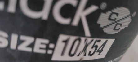

It is a clack 1054 tank. I have the same sized softener right next to it. I now have the calcite and the corosex in my possession. I have read that I need to:
put clack into manual backwash to remove water
shut water off
bypass clack valves
open water faucet to depressurize
use adjustable wrench to open port
I am not solid on some of those steps. I can look up how to put in backwash, but I am not sure if I need to disrupt that process or I just put it into back wash and it drains. I definitely need some clarification before I do this. I am going to weight out 5 pounds of corosex and mix it with 50 pounds of calcite. Thanks.

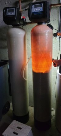

Here is the current media level. It is at 34 inches. I see some places where they suggest 2/3 full, which means I am only off by 4 inches and other places where they want 10 inches from the top. I think I was probably closer to the 10 inches from the top. It has been a solid couple of years since I touched it.

Bannerman
5,461
1,057
Ontario, Canada
shut water off
Backwash will not remove water from the tank. Advancing to Backwash after shutting off the supply valve will however drain off pressure from within the tank, so, you will be less likely to be sprayed in the face when removing the control valve or the media fill port.
Because your AN is equipped with a backwashing control valve, the media will be typically filled to 2/3 of the tank height, allowing sufficient space for the media to expand, lift and reclassify during the Backwash cycle.
