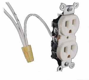

I wish I had known to open the box of the new switch before I bought it though. It seems that not all of the new 3 way switches have that slot where you can stick the wire in without using the terminal. For $4.79 each from Home Depot, I would have thought they'd have both the slot and the terminal. Mine didn't. It's just a little difficult to combine both the looped wire with a second wire on the same terminal but I man handled it. Thanks again.

Late now, but... you should combine them under a wire nut, instead, with a third, short length of wire leading to the terminal. It's called a "pigtail". Like so:
