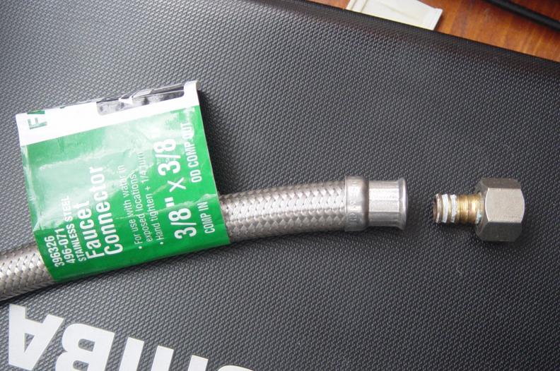

Well when the PE pipes let loose and flood your unit and the units below you, you're going to find out real fast what it means to be liable for your damage as well as the other units as well as any damage to the building. As I mentioned before just because a manufacture of an appliance uses plastic piping, does not mean it meets the local codes. I can guarantee you if you read the instructions that come with the water filter system, instant hot systems, even the refrigerator ice maker hook up, it will tell you that all local plumbing codes must be followed, and if there is no local codes addressing the installation of their product, then and only then, you follow the manufactures suggested installation.

Here you go, a nice picture of one of the type of failures that can happen with the bradded stainless steel supplies. I do hope your condo/renters insurance is up to date.
