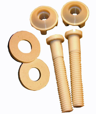

I found the white screws locally...AFTER I had ordered a new seat online!
For anyone who wants to save a BUNCH of money, the white screws are 14-1063, $2.50 per set.
I'd still appreciate your ideas on whether the hinge kit would have been a good alternative for the stripped screw problem.

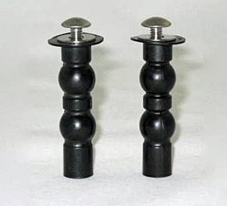

3,461
Normally on the older version of the MS874114SG Carlyle, you would use the seat toggles that can be installed from above. Part number THU-651N
