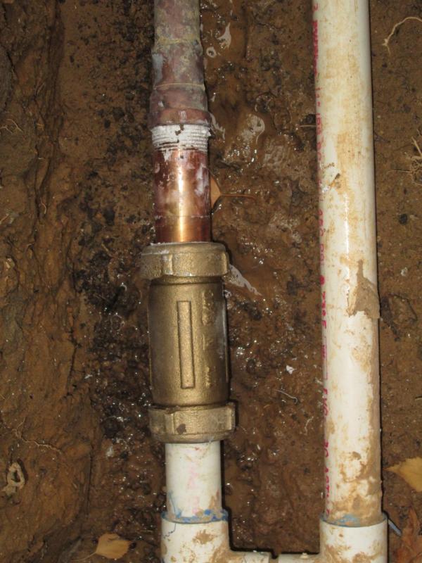

    From the water meter, I have a 1" PVC pipe which is connected underground to a copper pipe leading to our house. The PVC male thread which attaches to the copper female thread has cracked causing a leak. The male connector is gray leading me to believe it is schedule 80. I would prefer not to use another threaded connection and have read several posts on this subject. I am interested in a Dresser-like connector with bolts to tighten but am not sure which specific one to purchase.
    1) Are the brass or plastic compression couplings available at Home Depot good enough or should I try to find a Dresser type one with bolts?
    2) Can anyone recommend a specific coupling to purchase?
    3) Would it be better to attach a brass threaded nipple to the copper female to allow connection, per HJ, or would it be better to just cut off the copper female and connect to the copper pipe?
    Thanks,
    Pat

    If you want to make your job DIFFICULT, cut the female off and try to connect the PVC to the copper pipe. Make you life simple and use the brass nipple and almost any compression coupling to join the brass and PVC.

    I went to Home Depot, Lowes, Ace and Ferguson's. Because the OD on the PVC pipe and copper pipe are not the same, I could not find a compression coupling that would work. If it fit on one side, it wouldn't fit on the other. None of the employees had any other ideas but to go back to the PVC male adaptor. Does anyone have specific names of couplings that would work?

    You need to reread the part about using a brass nipple then the pipe is the same as the pvc pipe and use a brass "g" coupling to connect

    Oh yes. Forgot about the nipple. Back to the store.
    23,534
    quote; If it fit on one side, it wouldn't fit on the other.
    THAT is what would have happened if you cut the female off the copper. That is also why I said doing that would make your life miserable.

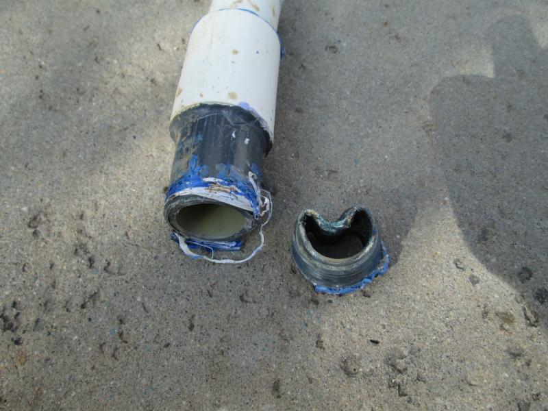

    Here's the finished product. No leaks so far. The plastic thread broke in the copper female. It looks like they used PVC cement to screw in the male fitting. I used a torch to heat up the PVC, got a small screwdriver to wedge between the PVC and the copper female. Then I stuck needle nose pliers into the space and gave it a few turns and it came out.

    quote; The plastic thread broke in the copper female.
    They ALL do, well maybe not ALL, (yet), but a great many do. That is where I expect to find leaks, either at the house or at the meter. A plastic male adapter is the "weakest" fitting made. Threading reduces the wall thickness so they have ZERO tolerance for stress or flexing, and therefore they crack.
