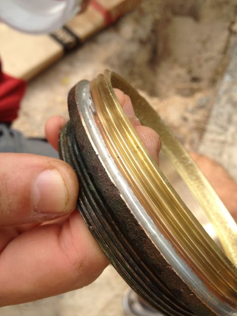

BigD
12
Hawaii
This is what happens when you have a father in law that is a semi-retired engineer with lots of tools!
Little bit of silver solder, a drill and a lathe and taa-daa! We have our connection!
Thanks for the help!
Denise

It is not permitted to use a fitting that would restrict or reduce the I.D. of the pipe. If you are using 4" pipe, any downstream fittings must be 4"
To add to that, the 3 threads you have on that fitting are not likely to be adequate for properly tightening any threaded pipe fitting.
33,608
1,047
Do you know one reason those cleanout tees have a 3 1/2" tap in them? It is so no one could use them as a connection for a sewer extension or revision. It is not an approved "drain fitting" because the opening does not have any "directional sweep" to it.
Well leave it to the retired engineer to find a "good way" to do it wrong. lol.

I guess if the thing screws on and doesn't leak - that's no good?
And if it's a straight line? Directional sweep?
I guess I don't see how a Fernco 3.25 to 3.5 is any different other than it doesn't screw on? But I'm not a plumber! ;-)
33,608
1,047
Your device makes a "reduction in size". There is NO "3.25 to 3.5 Fernco", because there are no 3 1/2" pipes. The Fernco or "screw on" would not be the problem if it were the correct size, but the fitting it is connecting to IS the wrong one.
