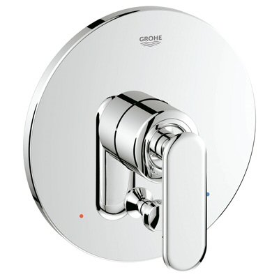

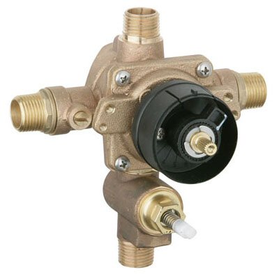

Hey Everyone,
I'm wondering if this will work just fine for my shower redo. I purchased a Grohe trim piece that has a built in diverter valve + a valve(see attachments)I'm trying to install a rainshower AND a regular shower head. Is there any reason why I cannot use the built-in diverter which would normally be used for a TUB spout to pour water but instead to activate the rain shower? (That way I don't have to buy another diverter, another valve, more plumbing stuff etc) just to make it a seperate handle is all (I don't care about having two handles)
thanks!!

The issue I see happening, is that since your main outlet will be to a regular showerhead, there is a good possibility that because the rainshower outlet will be open, that flow from the restricted regular showerhead will backup until it drips out of the rainshower head.
1,191
The 'shower' outlet relies on there being very little restriction in the other outlet (normally the tub spout). The diverter in that valve does not appear to actually block the outlet to the shower head (upper), but to block that from the (tub) outlet, which then forces it out the top for the shower. If you put a shower head on both outlets, since they are restricted, you'd likely get flow from both all the time until you used the diverter to stop it from one.

Ja, I agree with Jim in that the diverter does not look to be a true A/B valve and as such you will either split the flow between the two or divert it all to one. Before I renovated my shower, the old valve was a true A/B valve and as such, I replaced what would have been a tub spout with a wall union for the hand shower. I wanted to do the same for the new shower but the wife's choice of valve and trim didn't have that option so we now just have the hand shower. I made a feeble attempt to sway her but in matters of decor, she rules.
33,608
1,047
The hand held would operate the same as a obstruction so when you were using it it would also force water out of the shower head. When the diverter was operated, then the hand held would stop flowing and all the water would come out of the head.
