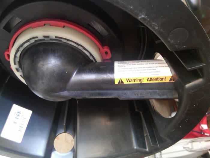

The Quick Connect fitting on my new WellMate WM-9 30 gallon tank leaks. Help.
Reference my earlier post (link: https://terrylove.com/forums/showth...ent-CSV-new-pressure-switch-Several-questions), I selected a replacement WellMate pressure tank because it appeared to fit my requirements. So with advice from two people on the forum (“ballvalve†and “Porkyâ€) I began the installation process. It was easy.

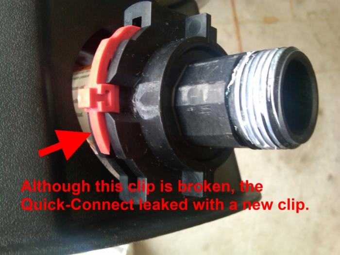

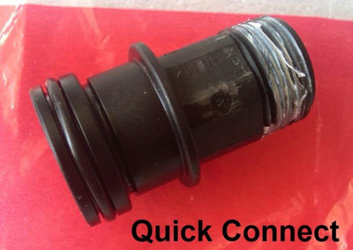

I cut the plastic fitting from the old tank that connected to the brass T valve. This allowed me to not touch any plumbing. After verifying tank pressure, etc, I installed the WellMate Quick Connect fitting to the brass T with Teflon tape. Then I slid the new 30 gallon tank in place.
The alignment was perfect. No adjustments of any sort were necessary. The tank was level, the quick connect was level, there was no binding whatsoever. Then I inserted the red “keeper†into place to secure the quick connect to the tank. Even though it looks like a chintzy setup, everything looked as though it was properly installed.

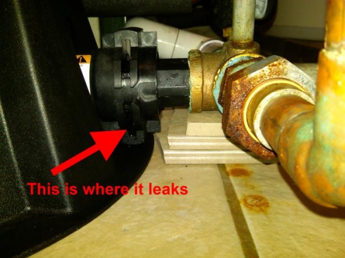

I turned the pump on and saw a leak. The quick connect fitting leaked, probably at the rubber o-ring.
After taking it apart, calling the distributor, re-verifying everything was spotless, and then re-installing it, I still had the same leak. The technician at the distributor said he doesn’t like to install tanks with plastic quick connects, including WellMate tanks. He also said where possible he hard-plumbs instead of using quick connects, but on my tank, it would be difficult at best. They’re sending a new tank, but my cottage is without water until next week.

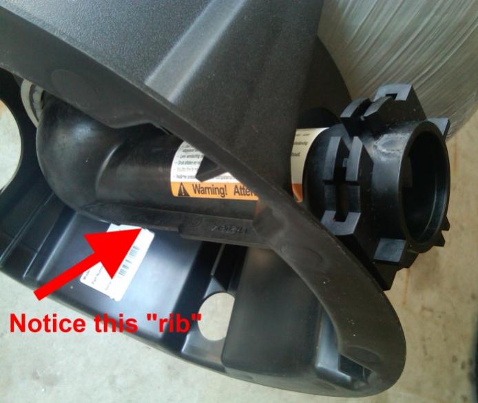

Anyone have experience with WellMate plastic quick connects? Given the constraints of the “rib†along the feed pipe, can this be converted to a hard-plumb?
I’m planning to install the replacement new tank Tuesday morning, and I don’t have a good feeling about it. Any additional advice is truly appreciated.

Why didnt you change the air cell on the old tank? It also looks like that entire waterway is changeable and some have threaded ends. O rings are quite reliable, a little lube helps. I would connect to that fitting with flexible hose or tubing to eliminate alignment and vibration issues.

I notice you have that plastic thread buried tight against the tee. Usually means one or the other thread is out of spec or you overtightened the plastic or underwrapped it with tape. I would use top quality teflon tape and more wraps than normal. Leaks can travel in very hard to notice paths.
Probably over-tightened. I had only one wrap of teflon. I am positive the leak was from the quick-connect and not the fitting attached to brass. However, I will give it a couple wraps and willmake it secure, not over-tightened. By the way, teflon or pipe dope?

There are all sorts of teflon tape. Some of the no name junk is probably chinese grocery bags dyed white and wrapped nicely on a spool. Real tape has a name on it, thickness in Mils, and was made somewhere in the usa. Gotta pay a buck or three, and you can choose a width too. Some pipe dope is not rated for plastic, so be careful. In an old fitting like that, I would wire brush the galvanized part, and probably use tape over a bit of permatex teflon thread sealant on the plastic. One wrap of cheap teflon will not work.
Try Graingers or the local farm supply store. Home depression will not have it.
