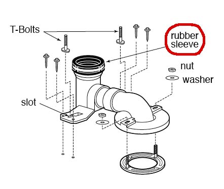

Thought of this after posting the Caroma note-and I don't know what you call the bits, not a plumber, sorry.
The last one that was installed, the plumber said there wasn't a piece included to screw it down with, he called and they said to just use whatever he had that would fit. He put in a screw but it didn't have a covered head, just a plain end. Seemed odd, but I haven't noticed it since, and I don't recall it being an issue with the other 4.
This is the long screw that goes down through the base at an angle near the back, into the floor.
The only other install thing was, they recommend to caulk under it when installing.
