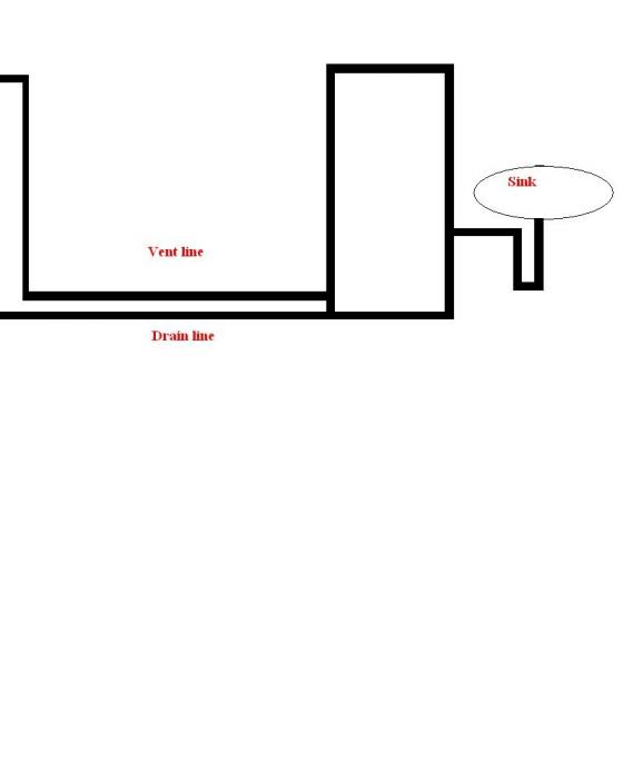

I researched and found that the vent must extend 6" above the overflow (or rim) of a sink, but I couldn't find anything that says it must remain there. Would it be possible to do what is depicted in the following sketch? If so, that would allow me to keep the plumbing chase low, depending on what the minimum might be for the sink drain.
The sketch shows the vent line extending up and looping back down to the plumbing chase level, then back up to meet the existing vent/stack ... similar to how an island vent system would work ... would this meet code?
A true island vent is drained.
You pictured loop would not drain.
A vent can be flat, but not dipped.
A lav trap arm can be up to 42" long.

So, I can not have the sink eleven feet from the 3" stack? Am I understanding you correctly ... or 42" without a vent? Also, If I was to connect the vent and drain at the dip, would that work to drain the vent?
Like this:

Okay, I looked into it and found that loop venting is ONLY allowable in an island application ... looks like I'll have to plumb a vent up into the attic and over to the stack.

Put a "spacer" around the toilet riser before you pour the concrete, so you can use an "outside/over the pipe" flange. But you are wrong about the loop/yoke vent ONLY being for islands. I use them anytime I do not have a route from the sink to the roof, such as a sink with all windows over it and lally columns or posts at either end of the windows.

So you're saying a loop vent would work fine for my sink? If so, what size should the vent pipe be? I'm also putting a second sink on the same line, which will be within 12" of the main stack; will this be a problem?
