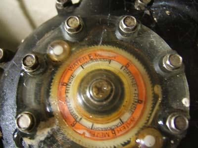

I'm really not to sure how old this softener is but I can tell you by the looks of it it's old. In the three years we have lived here the water has always had a hard water feel and a sulfer like smell to it. We were using some kind of regular salt in and were advised to switch to Clearwater premium Rust Out. This seems to really help with the hardness of the water however, My wife bought two bags just recently that was not the Clearwater. I reluctantly ran those two bags of salt through the system and noticed the water had gone back to the "hard and rusty" as I mentioned earlier. I refilled this time around with the Rust out and the water is now worse than ever. It's alomost like there is no softener at all. I noticed in another post the turing the dial on top should make different sounds but unlike their softener, ours does not have a "service" or "recharge" area on the dial. This sucker must be old. I would like to troubleshoot first as any man does before just scrapping the old and in with the new. What are some key points I need to check in the "problem" area that I may do at home to fix this water peroblem.
p.s. I have a 5 month old newborn and if it's not resolved soon I will replace the whole unit. I'm just trying to save the 1,500 bucks if I can fix it myself.
Thank you in advance for any replies.
I have included a few pictures.

The Kinetico is non-electric, and you have a Kinetico. I say water power, centuries old technology! Because of that they have to have a number of small gears with very close tolerances. Their name brand softeners are twin tank immediate regenerated, as opposed to two tank delayed regenerated which is the norm whether the resin tank is in the brine tank, a cabinet model like Sears, GE, Whirlpool, and other big box store brands, or separated. BTW, the big box brands last about 2-6 years at most and IMO are not the best quality.

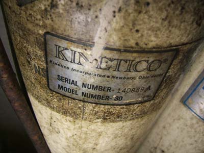

Your Kinetico looks like it might be from 1989 because of the number on one of the tanks. It has the FRP type tanks, they are smooth plastic as opposed to the rippled surface of a polyglass tank which is much more common and the norm. There may be something wrong with the control valve since you cant find how to operate it manually but they aren't very user friendly to start with. But more likely is the resin being iron fouled or the use of Rust Out in the salt wouldn't make much difference. If it regenerates on its own, mix about a 1/2 cup of Iron Out or Super Iron Out in a gallon of warm water and pour it down into the water in the salt tank, then let it regenerate. That will clean ONE tank's resin and the control valve. Then repeat so the other tank is done too. If the water gets better, then yer home free of charge except for the Iron Out (any grocery store cleaning dept).
If no improvement and the valve didn't go through a regeneration i na few days, then it's time to get a new one IMO. Because the control valve is not cheap to rebuild. You could put new resin in the tanks and a new twin tank control valve on like the Fleck Twin Flo100e, 9100 or 9000 but... it is not cost effective as compared to a whole new one bought over the internet and installed by YOU. And the tanks may be too small for your water quality and family size anyway; I think, I can't see the pictures now and can't remember since late last night when I first read you post, they are 8" x 44" which says 3/4 cuft.

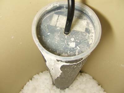

I have a similar Model 30, maybe a bit newer, that came with the house I moved into two years ago. The biggest difference is it also has a 3 position valve with Bypass, Off, and Service positions over about 120 degrees of rotation.
It has stopped consuming salt (potassium chloride). It has been over a Year since I dumped in the last bag and there still is a single chunk deep layer on the bottom with about 2 " of water topping that. I do hear it cycle occasionally but have never seen it drain the brine tank. Maybe I'm not catching it early enough in the Brine cycle, but I've watched it pretty carefully for a couple weeks now since I read this forum. I will try the Super Rust Out when I can find it, but now am wondering if there are any simple checks I should do with the brine tank, especially now with it nearly empty.

It can't be using salt. Put it in By Pass and disconnect the brine line and clean the salt tank all out and clean the brine pickup too and make sure you can suck air and blow through it. Reconnect the brine line, add 4-5 gallons of water to the salt tank and put it into Service and do a manual regeneration. Watch it for the first half hour to make sure it sucks water out of the salt tank. If not, you have something else wrong. If it works, add 40 or 50 lbs of solar crystal salt and do a manual regeneration and then add 4-5 gals of water to the salt tank and do another regeneration for the second tank.
You can do the Iron Out thing later if this works.
Get rid of the potassium chloride and use solar crystal, it totally dissolves and doesn't recrystalize or leave a mush to hard residue in the bottom of the tank like potassium. And it's like a 1/4 of the cost of potassium.
skicanoe
Thanks Gary for the excellent replies to Mobster and myself. You called it, Re-crystalization. The line was 100% blocked, the valve stuck and crystalized. I hauled it outside and took it apart and cleaned it all out. Under the false bottom like drain panel the whole area was stuffed with long needle-like crystals. I didn't know I could make it regenerate but figured that out (phillips screw driver to center of control).
