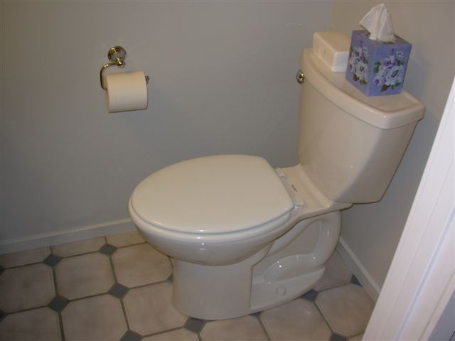

Is it my imagination, or are they showing this toilet sitting far from the wall?
Isn't that odd, and aren't round fronts supposed to be shorter than elongated? They say it's 30 1/4 long, but that is longer than any elongated I have seen so far.
Any experience with this toilet?

that gap looks large but the dimensions show it to be just an inch (25mm) for the tank's top rear edge.
1,191
Just use the search function in the blue bar..you'll find lots of comments on the Cadet, many of them not too good. Apparently an okay design with lousy execution...sometimes you get a good one, sometimes not. Many manufacturers make 14" rough-in toilets by just installing a different tank (i.e., thicker for 14"), so that would just add total length. It can get really expensive to make the complicated mold for the bowl in so many different configurations...tanks are much easier. Some do it differently - look at www.totousa.com and search on Unifit, or look at the spec sheet for say the Carlyle toilet. This one, and some others they make, uses an adapter that lets the same toilet sit on either a 10, 12(stock), or 14" rough-in. It comes with the 12" adapter, if you need 10, or 14", you replace the stock one with the new one...the toilet is identical, and always sits the same distance from the wall - it is always the same depth unlike those that just make the tank thicker or thinner.

Most manufacturers use a 12" bowl for the 14" rough, and a thicker tank.
The only manufacturer that moves the bowl back, is made by Toto.
The models that do this are elongated, however with the 14" Unift, it winds up 28.75" from the back wall.
That is quite a bit shorter than a Cadet 14" Round at 30-1/4"
A round bowl 12" Toto Drake would be 29-1/2" at 14"

Even though Ian was not around to back me up the last time I posted on this subject, he is right. :D The Cadet 3 is a great choice. To give credit to the nay sayers, just check the finish on both the bowl and tank before you take it out of the store. The design is fantastic. I don't think you will find any posts criticizing the flush on this model.
To throw sand in the naysayers' eyes, I wanted a 17" high seat, elongated bowl and the Everclean finish (Sanigloss on the Toto). Guess what; not available on the Toto Drake, which is their mere-mortal priced model. You can get two of the threre options, but not all three. I installed the Cadet 3. No finish issues. No leaks. Nothing ever left in the bowl after a flush, zip nada. The four knothead teenagers have never clogged it. It stays cleaner longer (a lot longer due to the Everclean).
Oh and last but not least; under two hundred out the door. :eek: Ian may have suped his up a bit with aftermarket enhancements, but it works great right out of the box.

She was wondering why the Cadet 14" was so long. It is long.
We were pointing out that if she wanted shorter, the best option would be a Toto with 14" Unifit, which brings it back to 28-3/4" and you get to have the elongated bowl.
If you don't mind 30-1/4" for a round bowl, then why not?

I agree with you, sixlashes and with Ian. My Cadet 3 "Right Height" model has been in place since March, and it is getting more use than my Toto Drake is (due to the fact that the Drake doubles as one of the cat's favorite bed, and is occupied for much of the time).
My Cadet 3 has not failed once, despite the workout that I give it.
My father has a Right Height model like mine (since January this year), and my next door neighbor, the round bowl Cadet 3 (since December 2007). Both are extremely pleased with them, report no problems with them, and can't believe how a toilet can flush so well with so little water. My father is also tickled that his water bill has dropped to minimum.
My gym, which opened in February, has two Cadet 3 toilets in the men's locker room, and I would guess the same in the women's and special needs locker rooms. They are doing quite well under heavy use in a business that runs 24 hours a day.
In my case, the Cadet 3 cost me $185. My Drake cost me well over $500 back in 2005. At the time I gave the half bath it's "face lift" money was the deciding factor as I had other things planned than just replacing the toilet (paint, towel / tissue holders, artwork). For me the Cadet 3 was a sound choice.

I (begrudgingly) agree that the Toto is more suitable for a 14" rough in. The unifit system is well engineered and works well with non-standard (10" & 14") rough in installations. There. :p
I was just defending my throne and got carried away. I know you operational guys love the Totos and smack down the Cadet 3's; I have to get in my props for the Cadet when I can :D
Truth be told, I was a little disappointed I could not get the Drake in the configuration I wanted (see my last post). The Drake was what I went looking for at the supply house. However; I am extremely pleased with the Cadet. When I find something that actually works I want to let others know.
