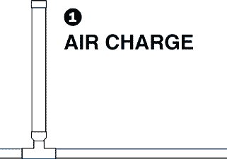

I understand that having high water pressure results in higher water bills, banging pipes and appliance breakdowns. However, there is a huge difference in comfort when using faucets and showers at 120psi as oppose to 50psi especially when multiple showers, faucets or toilets are in use at the same time.
Our house has static water pressure of 120psi but when I adjust our pressure reducer valve to make it 50psi, the pressure is way too low and aggrevating when multiples are in use. I have tried it at 80psi and still a little aggrevating. Our house pipes do not bang and our appliances work fine. So, is it OK for me to leave it at 120psi? Our water heater has an expansion tank that is pre-charged at 70psi. Is it true that you should not go more than 80psi. What problems may occur by pre-charging so high?
Please advise. Thank you!

I guess this explains why I had to replace my expansion tank within 2 years of installing it. It waterlogged. I am currently using a 2 gal expansion tank, is it better to get the 5 gal given by high pressure scenario? Does pre-charging it at a higher rate prolong the life of the tank?
Won't the expansion tank prevent the t&p valve from getting damaged?
The t&p valve pipe is already piped to a floor drain.

What about my questions regarding getting a 2 gal or 5 gal expansion tank?
Is it better to get the 5 gal given by high pressure scenario? Does pre-charging it at a higher rate prolong the life of the tank?
Is there a better manufacturer for expansion tanks or do they all work the same? Lowes sells Wellsaver. Home Depot sells Watts.

you would have to pump the tank up to 120 just to get equal balance between the pressures..

There is only about a few of spoonsful of water involved to create a large amount of thermal expansion so the size of the tank, and to a large degree the air pressure charge is immaterial. The only thing that will happen is that the greater the disparity between the air pressure and the system pressure the more water there will be in the tank, which could create a weight problem if it is not securely supported. The real problem with 120 psi water pressure is the tendency for faucet and toilet supply lines to rupture and flood the house.
