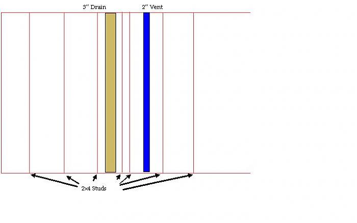

I'm stumped here guys and could use some help. I need to add a 2" washing machine drain to the setup shown below. There is a 3" vertical drain line and a 2" vertical vent line that I need to tap into.
I can't figure out how to pipe in the drain....here are my problems. The pipes are in between the studs. I want to use a flush mount washer drain box. I want the drain to be to the left of the 3" line.
Any help here...I can if needed fir out the wall with 2X's on their side.

Are you sure it is okay to add a drain at that location in those pipes? It looks to me like you are on the main floor and there are fixtures draining in from above, and I believe the plumbers here will say you need to do something different.
33,608
1,047
drain
From your drawing it is obvious that you do not have the room for the box where you want it. You will either have to move the 2" pipe, assuming it is a vent, because if it is not then you cannot make the connection anyway, or put the box to the right of the pipe.

This is one of my 3 main stacks in the house. I am adding this laundry on the second floor. Below is a 1/2 bath and the 2" line is the vent from the toilet that goes all the way to the third floor and connects back to the main stack just before it exits the roof(above all other fixtures)
There are other fixtures that use this 3" drain from above, there is a full bathroom that drains down this line.
I don't see why I wouldn't be able to tie into these lines, am I missing something?

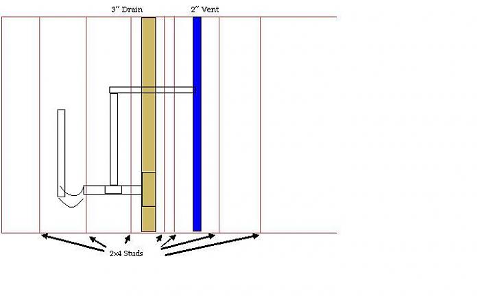

I was thinking of using a 3x3x2 tee into the stack then coming off with a 2" drain line to the washer trap. I would vent the line by putting a tee on it's back before the trap and running a 1.5" line over to the vent line on the right.
Sorry for the rough drawing.

Thanks for the help. I ended up plumbing it how I drew it except I took a 1.5" vent straight up instead of tapping into the 2" line and tied it into the 3" line up in the attic.
The 2" vent is galvanized and would be a PITA to cut and I would still have to fir out the entire wall to hide the pipe running over to it.
I was able to bore a 2" hole in one stud to the left of the stack and another 1.5" in the top plate to run my new vent out.
Looks great and I was able to use my box after all. Man I stared at that wall for a long time before it finally came to me.
