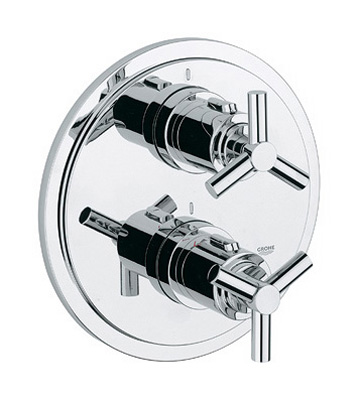

    Hi: In our new addition, the building inspector said we need to have "some sort of new fangled" shower valve, so we'll have to rip out the one we put in and replace it. Ok, he didn't say "new fangled", but what he meant was we'll need one that has an anti-scalding device. I've started looking for a new valve, but the trouble with this is that my wife wants a shower with two cross handles, not a single control valve. All I see is single handles. Are there any valves out there with separate hot and cold handles that are to code? Thanks--Marty

    Hi Marty,
    This particular unit pictured here is with a tub spout, but I'm sure they're made without it, or the outlet can be bypassed.
    What they've done here is faked the twin handle look with a temperature control on the right and a volume control on the left.
    So if your wife is dead set for this sort of look...........

    Your choices are a pressure-balanced valve or a thermostatically controlled valve. A pressure-balanced valve is almost always a single handle, a thermostatically controlled valve needs two controls, sometimes they are knobs, sometimes levers.
    19,397
    This one is from Grohe http://www.grohecatalog.com/product/19167/. Note, many of the valves can be bought with a rough-in valve, then you choose the trim. The rough-in and trim need to come from the same company, and there are often numerous trims that will fit a particular valve.

    (1) It's your house, but this is not really good advice. This will bite you in the rear if you ever want to sell the house. Also, around here, a job like this will have a rough inspection and a final. You cant put in a single handle on rough, then try to explain on final ( after the tile is up!) why the faucet changed!
    (2) You really haven't been paying attention to catalogs, showrooms, internet shopping, etc. There are gazillions of design choices out there, including plenty in the pressure balanced or thermostatic two handle variety.

    One handle controlling how much water, with the other handle controlling hot-or-cold, is actually really nice. You don't know what you're missing:
    You can turn the water off, to hear what someone's yelling at you ("honey, where are the keys?"), and when you turn it back on afterwards, the temperature is still the same as you had it. No fiddling around trying to find it again.
