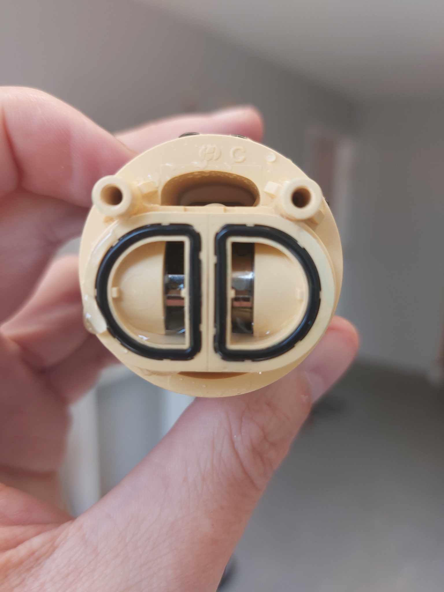

1. I removed the valve cartridge. Looking at the cartridge itself, I didn't see any noticeable damage or blockages

4. With the valve our and shower pipe removed I then tested turning the water back on. Interestingly, the water comes firing out of the cold side and full pressure, and barely dribbling out of the hot side! Hard to capture on video, but can see it here:
When testing with the valve in, I also noticed a quiet hum coming from the cold side suggesting there was a lot of backed up pressure, maybe? For some reason the hot water is not making it into the valve. Reminder that the line I tee'd into is from the bathroom above, which is getting hot water no problem. I tested and it took about 10s to get hot upstairs.
Based on this, it does not seem like the cartridge is the issue - it's either something in the hot water side of the valve body, or something in the pipe upstream.

It sounds like there is an obstruction in the hot. Since shower valves are pressure balanced this would then effect the cold. Since the next up upstream fixture is getting full flow its between those two fixtures. Better take it apart and redo it.

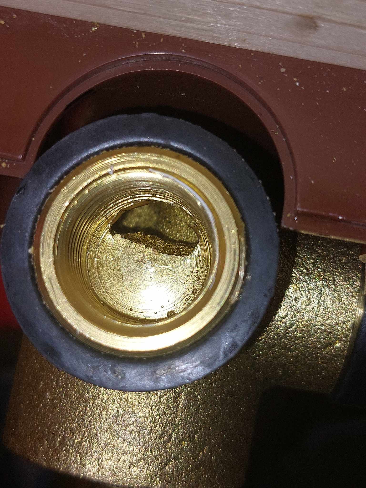

Update: cut the hot supply right at the valve to test. Turned water on and coming out with pressure and temperature! Must be something internal to the valve body on the hot side but not the cartidge. Nothing visible unfortunately so maybe it really is just a defective valve. The new one is on its way. I could try soaking this one in vinegar... but not sure it'll do anything.

looks like the hot side is plugged ? or Im blind is water blating out the hot and cold ports with cartridge removed? Sorry I havent re read all the posts.( see video in post 11)
vanDIY
11
BC Canada
No you're not blind, that is what is happening. Something blocked on the hot side in the valve body

CasaInc sent me new check valves (the small circles that the water was coming out of in the images and videos above). I was expecting to receive a completely new valve body. However, I removed the existing ones, whcih i hadnt done yet, and wouldn't you know it a little bit of wood shavings plugged in that hot water side. I flushed it out, reinserted the check valves... and it's working! I actually did consider this, but didn't find the culprit until now:
The cartridge being jammed with something seems possible. The valve came assembled and I have not tried to take it apart yet. All I can think of is that once I had it in place I did drill one more hole in the stud above so there was some sawdust that landed on it and maybe some got inside... we'd be talking falling a few feet into an opening the size of a 1/2" pex fitting, but maybe that's all it takes! In that case it would have come in from the shower outlet opening.
So in the end, user error... although perhaps not all valves clog that easily, I don't know. Feels a little silly to have gone through all this and in the end sawdust was the problem... but glad to have it working. Thanks all for your help!
