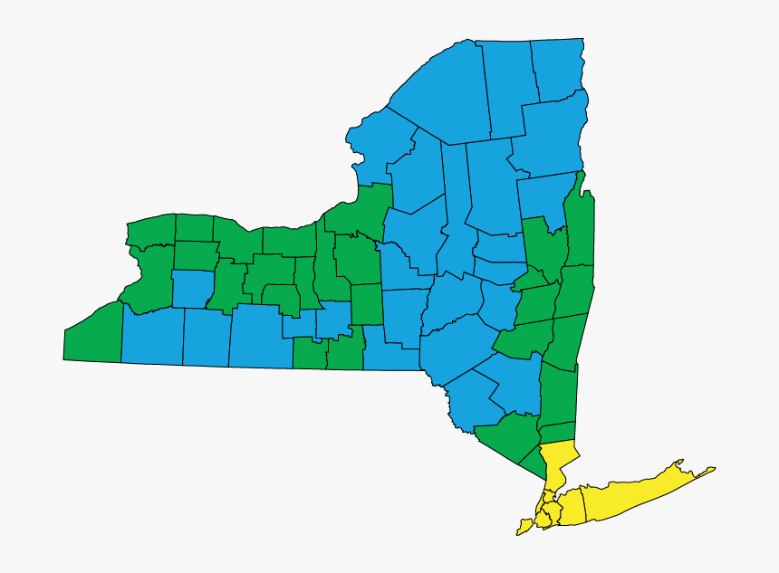

Unless you want the room to be cold, installing R13 rigid polyisocyanurate insulation (2", if foil faced) on the walls and R25 (4") on the ceiling of the exterior walls, and leaving the common wall to the basement uninsulated will raise the temperature in the vault to something near the basement temperature, which automatically lowers the relative humidity, and keeps the temperature high enough for the dehumidifier to operate without frosting up.
The foam can be mounted to poured concrete or concrete block with foam board construction adhesive (formulated with solvents that don't attack the foam).
If there isn't enough room to work within that space, insulating it from the exterior side with 2.5-3" of EPS (not polyiso, not XPS) on the sides down to a depth of 2' (in US climate zone 4 & 5 parts of NY, the counties in yellow or green below ) or 4' (zone 6, blue), with 5-6" of EPS above would achieve roughly the same results.
