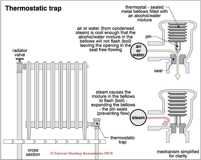

Lets get the basics:
  • One pipe steam uses a vent
  • Two pipe steam uses a "trap"
    • The lifetime of a conventional trap is limited -- 3-10 years
    • A trap can fail open or closed. A heat gun can help determine the difference
