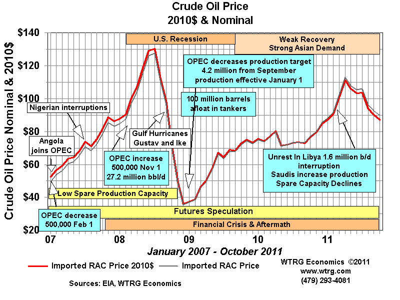

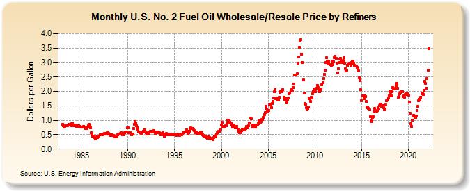

The biggest risk factor with oil heating is price volatility. Natural gas pricing is regulated by state utility regulators and long term contracts between utilities & suppliers. With oil it hardly matters that the US is net self sufficient on oil- the price of oil is determined by the international markets. At times when the Saudis &.0r Russians are in a price war to take more market share (or to put more US frackers out of business) the world price and local US price crashes. When regional conflicts or hurricanes take production off line the price rises. So $2.33/gallon for #2 oil, delivered might be your short term contract price, but there are many ways it can go higher.
Even contracts with local oil delivery companies can go south when the international markets see abrupt rises. During the intense crude price runup in 2007-2008 several #2 oil suppliers near me went bankrupt, unable to absorb the extreme price difference between their rapidly increasing price from their suppliers and the quoted seasonal contract prices to their customers. Seasonal fixed price contracts with their customers during the early autumn 2007 season did not anticipate the wholesale price more than doubling by December.
