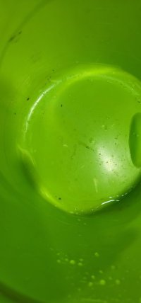

Still waiting for a test kit. Hach says there on backorder 6 to 8 weeks. My water guy came by last week and said my setup was fine. (i installed it myself) He did a backwash and said no air came out so switched me from 3 days to 2. Im still having staining. I disinfeceted the well with bleach to see if that would help but it didnt. Now I am trying to experiment with higher backwash flow and seen some improvement but still colored water when I add bromine tablet. I removed the drain flow button and got 10gpm however if you see that bucket there is a few small pieces of katalox. I know you dont want to wash out the katalox but is that small amount an issue?
Thanks

Are you sure the unit is drawing air in the "brine" cycle? You could have a clogged injector that would prevent it from drawing air. First thing to do is run a regen cycle manually and make sure it has a strong air draw. If it is drawing air the air may be slowly leaking to the drain after the regen cycle is complete.
Do a manual regeneration, immediately after it's complete pull the drain line off at the head. Put your ear down by the drain port and listen for hissing. If it is hissing the air charge is being lost. At that point you may need a new piston and seal/spacer set.

I am definitely drawing air in I felt the suction. During the day I hear dripping of water in the tank. I have not yet tested to see if I hear air coming out of drain valve. If I am reading this correctly listen as soon as the air draw cycle is complete and the unit is back in treatment mode. Not as it cycles from air draw to treatment.

you should put the drain flow button back in. you don't want media to discharge, not just because its wasting media but also because it will get stuck in the valve seals and cause leaks and excess wear. make sure you're not draining water out the drain line while the unit is in service.
you will hear water "trickling" inside the unit when in service and while service water is flowing. its water falling down in the air pocket inside, that's a good sign the air pocket is intact.

I did a backwash regen. then after the cycle finished removed the drain hose. The port that the drain hose sits in was full of water. No hissing sound and no bubbles
