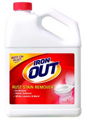

Typically expect the first 15 (±~5) minutes of a BD to draw out all of the brine. You either have a suction leak, or more likely, something needs cleaning.
You need clean your injector (2 parts -- throat and nozzle) and your injector screen. I would also treat your system with Iron Out. Use the search box above, and search for old posts in the softener forum that contain "iron out".
https://www.menards.com/main/grocer...mover-9-5-lb/io10n/p-1444444183163-c-7097.htm
When you use a softener for significant iron removal, you are signing up for extra cleaning.
