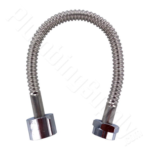

The corrugated toilet connectors, as in the picture, look interesting. I think the top gets secured to the 7/8 fill valve with the coupling nut that comes with the fill valve, and the bottom would connect to a 3/8 compression output with a ferrule and nut that comes with the valves. Do I have that right?
Also, there is a different one that has the threaded connectors on the end like the stainless braid-covered lines do. You can get that with the 7/8 fill valve connection and 3/8 compression or 1/2 inch FIP on the other.
