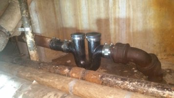

Any storm line roof drains for example, yard drains, area drains must have a a trap 40 pipe diameters upstream of a sanitary drain when connection to it
Also when using a combination sewer the storm traps as mentioned above OR can be in a separate system and have a separate main storm trap to avoid having individual traps and the storm running trap shall be tied in by a wye to the main sewer past the sanitary trap
When working on a 27 story building there is no separate lines storm /sanitary in the streets in NYC even though it was proposed in 1968
The problem is subways, utilities and the costs associated with tearing up the streets and then having the pitch to discharge the waste / stormwater
Running storm trap connecting to a sanitary system . Built in 1863
Sylvan
Still learning
2,766
695
New York
Church over 116 years old
