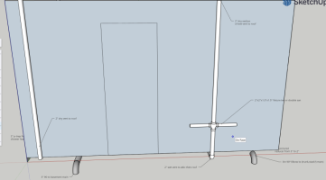

Hello! This is my first post on this forum but have been using it as a resource for various projects. I am hoping to get a little advice on my DWV rework for a bathroom remodel. I plan to get this work inspected so pointers would be much appreciated. Please see the attached proposed plans along with pictures of current state.
Background
I am remodeling a home built in 96. I was hoping to swap the shower and vanity locations (both 2") and just move the tub a few feet. After opening everything up, I think I am seeing some code violations already. I am hoping to salvage as much as I can from what is already in place. Specifically I am hoping to put as few new holes in the joists as possible.
Local Code
This remodel is taking place in Forsyth County GA. County should be following IPC with a few GA state specific amendments. I don't think these amendments will be related to this project.
Questions
1. Am I correct in thinking that the horizontal dry vent below the flood level rim pictured in bath-lav01/02 is an IPC code violation? I am not sure how this passed inspection originally.
2. I would like to get feedback on my current plans (bath-lav-prop and shower-wc-prop). Do you think they would pass inspection (assuming the install was proper)?
3. Would the wet vent length pictured in bath-lav-prop be acceptable? I am unclear whether the total slope for a wet vent can exceed the pipe size similar to a trap arms. I am under the impression the only requirement is to maintain 1/4 per foot slope regardless of length. Seems like you could run into the same trouble as with excessive trap arm length though. I can make new holes and shorten this run if need be. I have plenty of leeway on the tub trap arm length.
4. Should/can I switch to a 1.5 inch dry section of vent in shower-wc-prop? I am pretty sure this should meet code but I wasn't sure if it would be a good idea for a double head shower. 1.5 would be easier to put in the wall but I don't want to undersize.
5. If all seems well (unlikely), are there any reasonable recommendations to improve the system? I want to pass the IPC inspection but I also would like this to be a good long term solution.

I did attempt this with the bath-lav-prop and shower-wc-prop drawings (prop short for proposed). It sounds like those were not successful in conveying the proposed bath layouts. Looking at it now, the sections labeled "vertical drain" are kind of ambiguous. These were meant to display the two separate 3" pipes that ultimately travel vertically down the first floor wall to connect to the 3" main line out of the house that is down in the basement. I drew these separately because the two sections of plumbing are pretty much separate except for where they connect to the main 3" (trunk?) in the basement. I think you are saying it would be better to have a single drawing instead of the two separate drawings? I tried to describe the fixtures using the appropriate pipe size and trap location. Would more descriptive labels be helpful to better describe the fixtures?
I will see if I can get a more clear proposal tomorrow. Sorry this is my first time doing this. I really appreciate the feedback.
Ds0440
GA

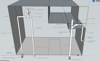

Alright, I ended doing a full 3D model instead. Took a bit longer but hopefully this will add a lot of clarity. There are a few different views of the full layout. If you cannot see a tag in a particular view, there should be a different view with the tag visible. Please let me know if I am missing any details that would be helpful. Below are reworded questions to go along with the new proposed layout pictures. Thanks again.
I just noticed the reduction in picture quality after they were uploaded. All of the pipe/fitting sizes/lengths/types are noted in the paper drawing. If you are unable to read them, let me know. Also, ignore the actual fittings in the rendering. I had trouble finding all the actual parts so I just made some work and labelled them with what they were actually supposed to be.
Questions
2. Do you think this plumbing layout would pass inspection under IPC assuming proper installation?
3. Would the long wet vent for the bathtub be acceptable? I am unclear whether the total slope for a wet vent can exceed the pipe size similar to a trap arms. I am under the impression the only requirement is to maintain 1/4 per foot slope regardless of length. Seems like you could run into the same trouble as with excessive trap arm length though. I can make new holes and shorten this run if need be. I was just hoping to leave the joists alone if I could.
4. I am unclear on what the dry piping size is actually required to be for the shower and toilet vent. Would 1.5 work instead of 2? This would make the install easier but I don't want to under-size.
5. If all seems well, are there any reasonable recommendations to improve the system? I want to pass the IPC inspection but I also would like this to be a good long term solution.
