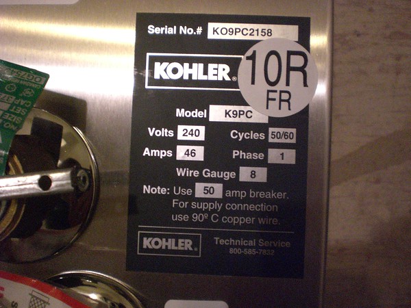

Kohler 1733 residential steam shower generator.
240 V, 50/60 Hz, 50 A
Rated an 9kW
6/2 or 8/2 gauge and what type(s) or wire?

50A maximum allowable on #8 THWN. However 9KW isn't 50A or even close to it so I'm a bit confused. I don't think you have to derate for a steam shower as you do for space heating ( I looked in the NEC handbook, but didn't see anything mentioning it). If the manufacturer says use #8 I'd say your fine with #8 unless you need to derate for long distance (voltage drop) or high ambient temperature (unlikely). You can use 8/2 romex unless your local codes say otherwise.

Mfg states 50a breaker for this steam shower
This a 240v connection, 2 hots
No GFCI breaker on these per Mfg spec

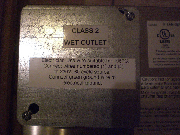

That's correct on GFCI. From Kohler manual:
NOTICE: Do not install a GFCI to this unit. This will prevent nuisance tripping.
NOTICE: All electrical wiring must be done in accordance with local codes.
Turn off all electricity to the working area at the main breaker panel.
Connect 240 VAC electrical lines to the wires labeled ″1″ and ″2″ coming out of the steam generator.
NOTICE: The steam generator should have a dedicated circuit breaker.

As per the NEC NM Cable has to be rated from the 60 deg. col.
Therefore #8 NM is only good for 40A.
#6 NM is only good for 55A.
Also install by MFG instructions not by a caculation off of the 9kw rating for the heat. Other things are involved in their UL listed rating.

S0 either 6 TW/UF or 8 TH*?
Their instructions do not spec wire, but there's a sticker on the unit says use 8 gauge wire. No mention of type. Is it bad to upsize in this case?
1,193
The wire must be big enough for the breaker. If they specify a 50A breaker, then you need at least the gauge wire required for that. Don't know what that is, but other than price and the hassle of working with it, larger is okay.

Just looked at it again. Sounds like what I need is THW 8/2?

As already mentioned, if your going to use NM type cable, then it cannot be smaller than #6 AWG. Personally if I was doing the job thats exactly what you would get, 6-2 NM cable supplied from a 50 amp breaker.

What about the 80% rule. Bimmerracer's steam generator seems to have a rating of 46 AMPS. Would it not be code to pout a 55AMP breaker?? even-though the manufacturer calls for a 50AMP?
