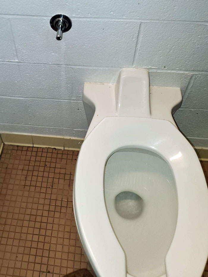

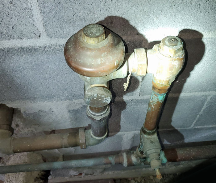

American Standard Afwall seen in a rest stop with the flush valve in the wall behind.
Elijah
Professional Idiot
Bethesda, MD

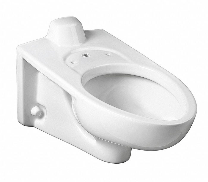

The toilet in that picture is actually an American Standard "Glenco" 2500/2502 bowl. The Afwall bowls from the time period that those Glenco bowls were produced looked like this:
Top spud American Standard Afwall bowl from around the late 1980s in a community/rec center built in 1989. Both the Glenco and Afwall bowls were available in both top spud and back spud configurations.
