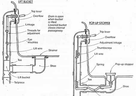

Phatbrain
17
Pacific North Wet
Stoppers
I lifted this image from Peter Hemp's book (and used without permission I might add...) "Installing and Repairing Plumbing Fixtures" - Taunton Press.
It may help.
fajmerchant
Rod Out -- But Nothing With It
Thanks for that diagram.
I managed to truly muscle the rod with a pair of pliers and finally get it out -- it's thick brass, maybe 3 inches long. The problem is that whatever was attached to it didn't come along for the ride. If I reach into the overflow hole, I can touch it -- it's thin brass or something, seemingly with screw threads on it.
Does anyone have advice on getting the rest of this out? Or is this now past the point where a novice like me can repair it?
