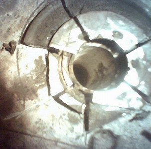

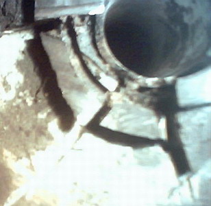

I am remodelling an upstairs shower in a 30+ year old condo. I was originally just going to re-tile the walls and curb, but that plan fell through when the curb fell apart with the tiles. It was made from mortar with clay bricks as a base. The showerpan liner was over the top of the curb and it disintegrated with the removal of the tiles. There was no salvaging it and it was just a mess.
So I have ripped out the walls and mudbed to bare studs and concrete floor(yes, concrete is what the upstairs floor is made of). I removed the showerpan liner, but the drain assembly is presenting a problem. There are three pieces, the top part which held the drain cover. That is screwed into a cast iron nipple which is screwed or cemented to a cast iron flange. The latter two pieces held the showerpan sandwiched between them to make a watertight seal. There is ample rust in all of this, but even with liquid wrench I cannot get the treaded part apart.
I have been trying to use a wrench on the nipple piece but it's either cemented or just too rusted to let go. I cannot buy a wrench big enough to go around the top portion. It measures roughly 3.5" and none of the wrenches at either Home Depot or Lowes can go around it.
I want to remove this as easily as possible since I think this cast iron is over PVC. Inside the drain looking down the pipe is white plastic. I'd like to preserve this if possible.
I do not have any access from below so all of this must be done from the top.
My ultimate goal is to switch to the Kerdi drain system and use the kerdi shower tray kit.
Any help or comments will be appreciated.
I have attached photos of the drain.

Master Plumber Mark
5,538
357
83
www.weilhammerplumbing.com
get a new one--dont save 6 bucks..
its not a big deal at all.....
either you got to attack it from underneath or cut a large hole
through the floor and get to it that way....
its most likely tied into the PVC with a no-hub coupling
and all you got to do it take it apart with a socket wrench...
or cut the pvc off shorter and build it back up
dont shake up the pvc pipe too much---or you might crack a
jiont somewhere back whee you cant reach it...
I have done that before...so be careful...
cut it out and then just get a new drain made out of PVC
be sure to get EXACTLY the same type with the clamping
ring for the pan and you will be in very good shape...
to install the new pvc pan floor...to yournew drain
You may have to cut out some flooring to get to the lower end, if there is no access from below.
Wood can always be put back.
That's what lumber stores are for.

I am not sure what kind of drain you have, but I have never seen a two piece cast iron one that screws together. In fact I would have concerns about the liner if the only way it was clamped was by screwing the upper piect in. Most cast iron drains are held together with three bolts, but they may be concealed in the mortar still stuck to the drain.
A kerdi drain is glued to the pvc or abs riser (it comes in both configurations) and then the Kerdi membrane is applied with thinset to the flange of the drain, no screws, clamps, or weepholes, since the membrane is tileable. The only critical things about installing it are that it is fully supported under the edges, and it is level. Well, getting the membrane fully stuck on the drain is critical as well.
Oh, wonderful.:eek: The drain is right over my living room ceiling. And I have a textured ceiling that's original. I hope to not have to cut a hole in that ceiling unless it's a last resort.
its most likely tied into the PVC with a no-hub coupling and all you got to do it take it apart with a socket wrench...
No, no bolts for a wrench, this is 40 year old construction. :(
The condo was apartment in the 60s then converted to the condo I no reside in in the 70s. There are three pieces as I said. I have now further dug into the flange assembly. I used an angle grider with a cutoff wheel and have cut off most of the top part. It was brass I think, and as I said threaded into a cast iron nipple. The nipple is also threaded into another piece, a flange. I can now confirm this from visual inspection of the cross-section of the metal. The bottom cast iron is around a piece of PVC pipe. And the CI is packed with okum or something else that melts when heated as the grinder is making liquid goo as I cut the bottom apart.
dont shake up the pvc pipe too much---or you might crack a joint somewhere back whee you cant reach it...
Yeah, I'm aware of that. I've already moved it up and down a bit so if I've done any damage it's happened already.:eek:
cut it out and then just get a new drain made out of PVC be sure to get EXACTLY the same type with the clamping
I'm going to switch to the Kerdi drain so I need to get at the PVC pipe and cut it off low enough to attach the drain.

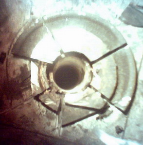

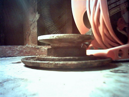

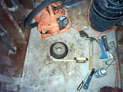

Here are more pictures of the drain. You can see there is the part around the middle PVC pipe then two more rings which are the threaded parts of the CI pipe. Sorry, the pics are so blurry. The pipe is reflective and it whites out the image.
Well, it worked the way it was for over 30 years and as long as 40. ;)
The condo is as I said 30+ years old, but the building goes back to 1965 or so. It was apartments back then.
When I removed the showerpan liner the concrete was bone dry. Not even a single spot of mold or even sign of water. And to top it off, the floor is flat and a desert. No preslope at all. The mudbed though was in two layers, with the second one sloped toward the drain.
I have since begun to cut up the flange assembly with a cutting wheel in a grinder. Looking at the way it was put together I think there's lead and okum as a packing in there around a PVC stem pipe.
See my post above to master plumber mike for more pictures of the drain.
As I've gotten further down to the bottom something gooey is coming out as the grinder heats up the CI. I'm going to try and cut the CI up as much as I can without disturbing the PVC pipe held within.
If I can just cut the PVC off to the right height when I get the CI off I'll be good to go with the Kerdi shower drain.
