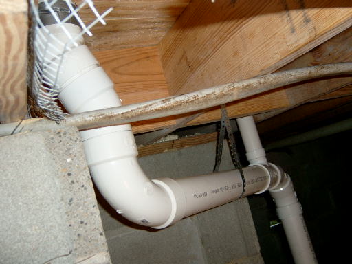

I've attached a photo of my proposed drain / vent for the toilet. The
pipes shown are not glued yet. I wanted to be sure this configuration is ok for code and whatnot.
What the photo is showing from top down is the flange, then a 45 degree elbow, then about 24" of 3" pipe connecting to a 3x2 Y to vent. I could not vent behind the toilet due to electrical panel behind the toilet wall, so I'm venting up the wall adjacent and next to the toilet.
Can anyone tell me if this is ok to go with ?

Not stepping at all.
The reason I even mention codes and location, is inspectors being who they are, and how large this country is, there will always be some differences.
What I see are nice wye fittings and 45 els. It looks nice.
The toilet is one of the few fixtuers that can be vented this way.

Hi Naumoff,
I'm in GA. I really appreciate your response. I'm sort of getting the impression that coming straight off the flange at 45 degrees for several feet then venting is a little peculiar. I've seen pictures similar to this in one of my plumbing books.
I am considering changing this setup so that the drain pipe goes down
vertically from the flange to just below the joists (about 8.5 inches) then doing a 90 degree and heading directly under the 2" vent pipe connecting to it and the 3" drain using a 3x3x2 combo. I suppose that would be more normal
than what I have in the photo. But, I don't know how far below the flange I'm "allowed" to go before the 90 degree turn. I need to be below the joists.
The thing that plumbing books don't talk much about is whether it's ok to run drain pipe at various angles that are not the usual vertical or horizontal with the proper slope per pipe diameter. I know there's issues with fluid speed at different angles, but not much more than that.
Suggestions welcome ! Thanks again... :)

Different Toilet Drain config...
Hi,
I've changed the drain/vent config. What say ye ?
Look better ?

Frankly, I like the old picture better.
The new picture would not fly where I plumb.
The 3x2 santee would need to be replaced with a 3x2 wye or combo fitting.

Thanks for the look...
Terry,
I thought w/ my old config that the 2 foot long 45 degree drain pipe
was sort of a no-no, which is why I went to this new configuration.
HJ,
I think I know what a Y-1/8 bend is, but I'll need to look it up to be sure.
Not sure why though that the existing T is an issue. I wondered about the sanitary T; but I thought it was more that you had to have a sanitary T for the drain line rather than it being an issue used in a vent. Thought wrong, I guess.
Thanks again guys. I'm almost ready to kick this project into gear.

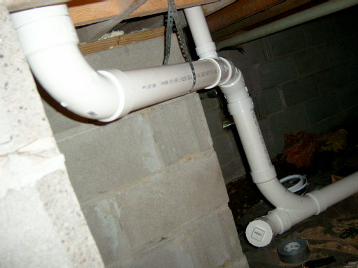

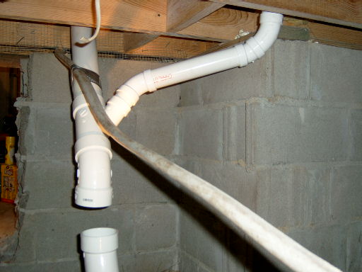

Hi Terry/HJ,
I think I've done your bidding. How does the Y w/ 45 look now for vent?
I've also attached a photo of where this 3" drain connects
to the main 3" drain running the length of the house. Does that
Y look ok to connect? I had planned on cutting two short pieces on
either end and connecting with those screw-tight rubber connectors.
I originally bought an all rubber Y, but the angle of its Y is not right and
I didn't like how the inside diameter looks smaller to me than regular 3" pipe.

You will want to go with a metal sleeved coupling.
They call these shielded no-hub couplings.
The metal shielding prevents the pipes from shifting over time.

Thanks Terry;
I'll return the rubber ones w/ metal straps and pick up some of those.
I really appreciate the good advice; thanks again.
