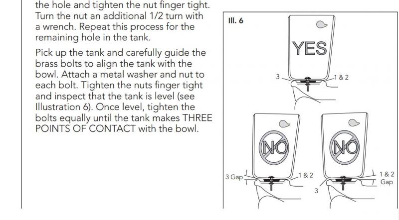

You want the tank vertical so they are just touching, or the thickness of a piece of heavy paper apart. Once one just-touches, STOP, you can't compress china. Then see how the other contact points are doing. If they are a sheet or two of paper away, that's probably good enough. If more, loosen, straighten, and try again, slowly and alternating frequently side to side. The extra effort you put in will pay off in pride, and a nice secure tank.
A lot of people seem to start worrying that they are going to crack it when the rubber gasket starts giving resistance, but nothing is even close to touching. If nothing is close to touching, the resistance of the gasket shouldn't cause anything to crack. Again, once something touches, go no further. As noted, you can actually stop just before it touches, but getting that gasket well-compressed is your mission so it doesn't rock.
I have mounted and remounted a fair number of tanks now, and haven't cracked one, new or old, yet, following this approach. But you do have to watch carefully to make sure nothing is touching.

The key to pulling the tank down is to alternate tightening sides frequently. Eyeball to see that the points are coming together evenly. You don't have to get in with a micrometer, just look at the spaces. Tighten a little bit at a time on each nut. When it looks close, use a business card in the space. When the space closes enough to put resistance on the cards when pulling on them, that's enough. You could tighten a tad more and actually bring the points together, but not really necessary. Keep it even as you go, changing sides frequently.

Now I just need to get the tank touching at all three points. I get spooked when it is china, hope I won't crack the bolt holes.
The manual is very clear that the tank and bowl should touch at all three points. It took me a few tries to get it to tighten down evenly front to back. Make sure to tighten the bolts evenly, as others have said. I had to reset the tank a couple times. My Mansfield Cascade was definitely easier to install.
I don't think leaving it a little loose will really hurt anything, but I didn't want the tank to knock or move when flushed.
