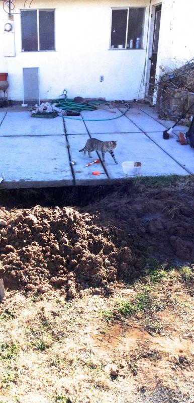

IMG_0128.jpg From the hole to the house

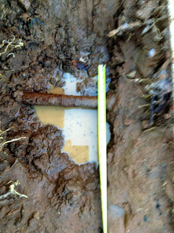

IMG_0129.jpg This is the pipe that is leaking somewhere

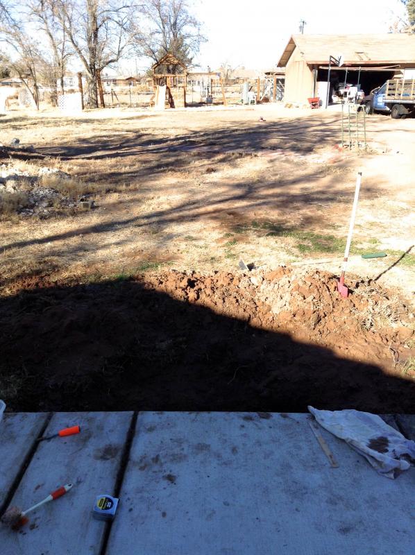

IMG_0127.jpg From the hole looking toward meter 300 feet thata way

I would rent the trencher and run a new trench from the meter to the house.
The PE tubing Jim is talking about is good stuff, and fairly cheap. The tree roots will not effect it in any way. Make sure you buy the tubing that is rated for potable water use. You could buy one roll long enough for the entire distance and have extra to spare.
The pipe in your picture looks like old galvanized pipe, and if so, it would not be worth trying to fix.
It will just be leaking somewhere else in a few weeks.
