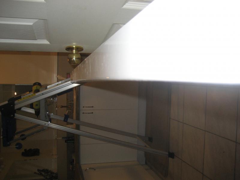

    Hi Folks...
    As I'm preparing for a new shower install in the basement I decided
    to bring the acrylic base from the garage to see approximately where
    the drain would end-up etc etc etc....
    It was standing up right in the cardboard in the garage and
    when I put it on the floor I noticed it was curved a bit on both axes,
    the middle being the most protruded on the 4 sides.
    I'm keeping it inside for the night to see if it will straighten-up..
    Any comments???? is this normal???
    Regards

    DIY Member royerm's Avatar
    Jul 2010
    Quebec, Canada
    91
    UPDATE UPDATE......
    2 days later now and I noticed that the sag is not only on the bottom
    of the base but more evident on the top part.
    I've send a picture to the store owner and he has agreed to exchange.
    I Have join the picture, not the best photographer the bottom of the base
    is against the door... Name:  IMG_3133.jpg
