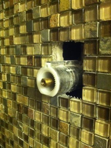

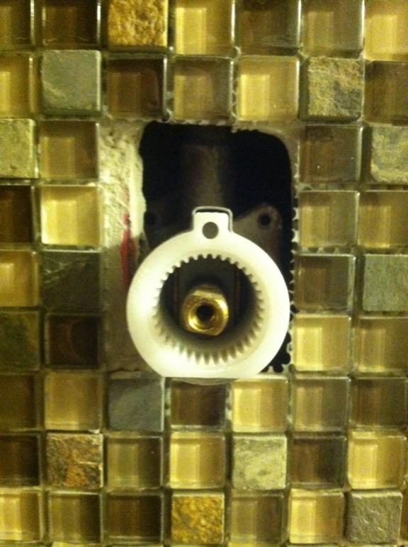

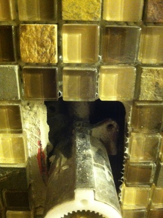

    Trying to ID the shower valve so I can get a get new fixtures, any help would be appreciated. Thanks.

    Moen Posi-Temp
    The plate attaches with two screws positioned on the diangle.
    You may have to cut some tile out on the lower left.
    You already have the valve, the trim number starts with a T
    http://www.moen.com/bathroom/faucets...arity&offset=0

    Thanks a lot for the help, time to get some fixtures.
