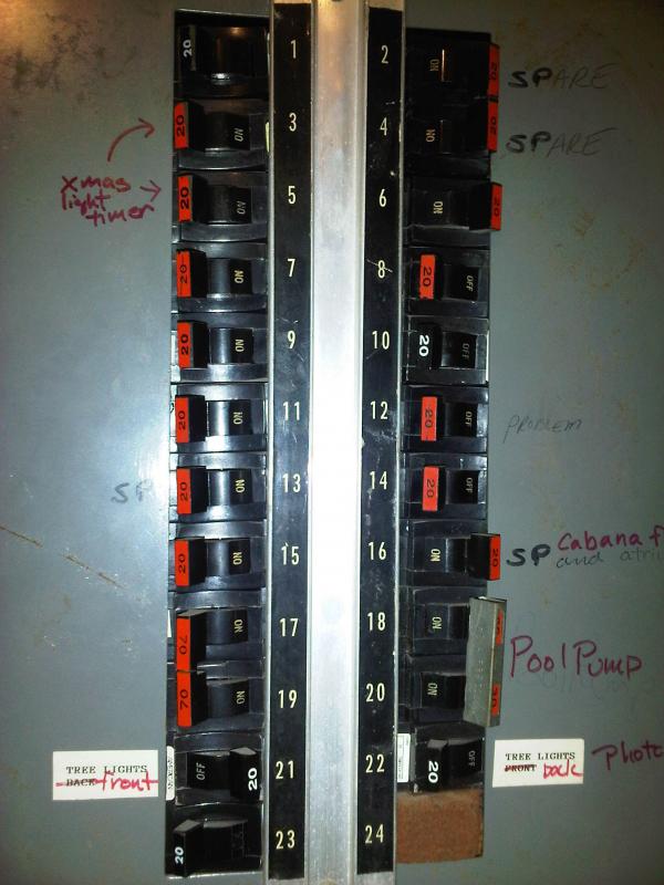

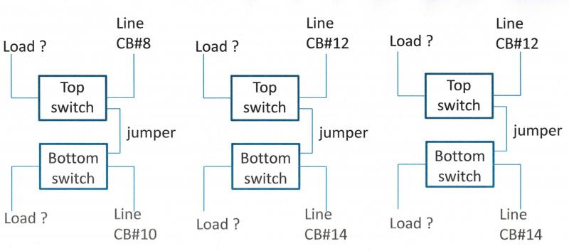

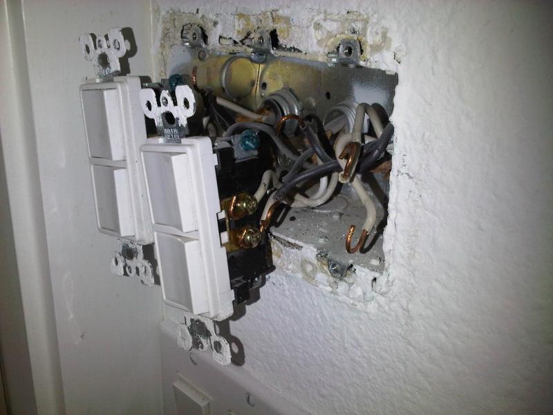

    Here are photos...a diagram of the three dual switches, a photo of the garage circuit panel with CB #8,#10, #12, and #14 all flipped off, a photo of two of the switches (one is removed completely, and the others have the wires loosened). Name:  diagram of three switches.jpg

    If breakers 8 and 10 were connected to one switch they would trip.
    If breakers 12 and 14 were connected to one switch they would trip.

    Look at 18 and 20, they are one 240 volt breaker. If any two breakers that are side by side in the panel are supplying the two single pole switches as pictured there will be a short circuit causing one or the other to trip if not both.
    The two switches with the thing you are calling jumper are two single pole switches on one yoke.

    Well, meweber1000, the problem is you keep making assertions about this strange wiring, but you never provide any convincing steps that
    you have taken to base those statements on. Unless we are mistaken in the belief that vertically adjacent breakers in that panel attach
    to opposite phases, the little diagram you posted is complete nonsense.

    JWelectric...ok I spent all this time making a pretty diagram and then I mislabelled it. I don't blame you for just wiping your hands of me. Sheez. It's actually 8 and 12 powering the first switches, and 10 and 14 powering the others. I'm so sorry, and no wonder you all think I'm an idiot. But really...two CBs are simultaneously powering each dual switch...even if I can't make a diagram without typos. I've lost all credibility.

    " It's actually 8 and 12 powering the first switches, and 10 and 14 powering the others"
    Those are respectively on the same phase. They will not trip the breaker. you have two different breakers supplying one switch, which is a mess in itself. JW was trying to tell you that if it were 8 and 10 (one phase and then another phase) then it would not function because it would create a dead short between both phases. There is no need for the setup you have there and I would label it as dangerous to have two different breakers running the same switch. Hope you figure out that mess with an electrician. I'm just a homeowner with some wiring experience.

    I believe you, but that is the trouble with internet diagnosis. I thought they were the same phase. It explains alot. However, there is no logical reason for it. Perhaps the switches were replaced, and no one broke the straps(links).
    You still have a myriad of issues there, among them, multiple circuits in the same box without dividers or handle ties. It's not even close to legal. Liabilty wise, I have to advise you once again. Get a local sparkey out there. If you want to make it safe. Cap all the wires off with wirenuts while all power is off, tuck them in, and install a 3 gang blank cover. My last best advice.

    meweber1000, from the photo you posted I can tell you that the switches can feed two different loads from two different breakers.
    I can't tell if they are wired properly.
    I can tell you that a device like the switch you have, when fed from two different breakers should be on a breakers that have a common trip.
    The panel you have is obsolete and has a bad reputation. If you do a web search on FPE panels you will find no shortage of negative comments.

    IF they are adjacent, the #8 and #10 should be on different legs which would create a 240v circuit and blow one or the other, and possibly the main breaker, if they were connected together. The same with #12 and #14. This is a valid assumption since your pool pump is 240v and it uses adjacent breakers. Something is erroneous in your diagnosis. You could safely connect #8 and #12. And #10 and #14.

    I see a safety issue as you have it: the load on ONE switch could short, drawing well in excess of 20 amps and the NEITHER breaker might trip until he total current thru the switch and load wiring neared 40 amps
