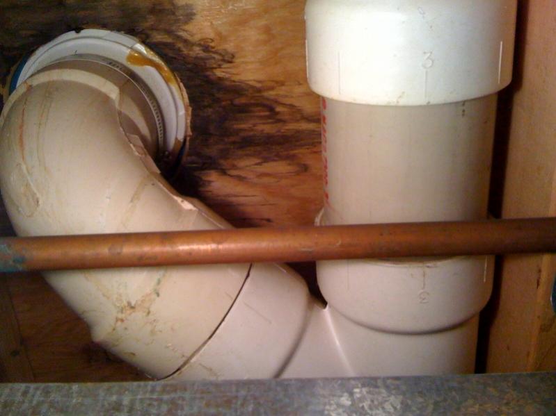

Right now the closet flange has a very short 3" section in a wye on it's side that goes into the side of the main drain.

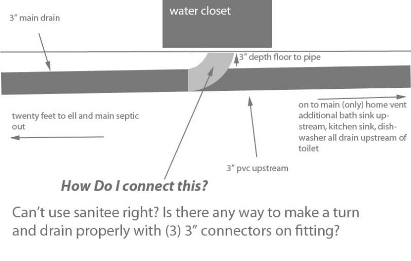

So in this attached pic, this is plumbing as it exists right now.
Vertical line on right is main 3" DWV pipe for house. Current toilet out on left. I want to put the toilet drain directly over it somehow if that's possible. If there's a way, that's going to be the best solution. Can I use a 3" x 3" x 3" spigot closet bend or something like that?

Here's a diagram of what i am talking about and what I want to do - have the WC directly above the current main drain.
With only 3" empty space above drain pipe.
33,608
1,047
In its simplest terms, NO. That toilet, because other things will be flowing past it, needs its own vent. How you arrange, or rearrange, the piping to accomdate it depends on factors we cannot see in your pictures. From the pictures, however, what you have now might also be improper.

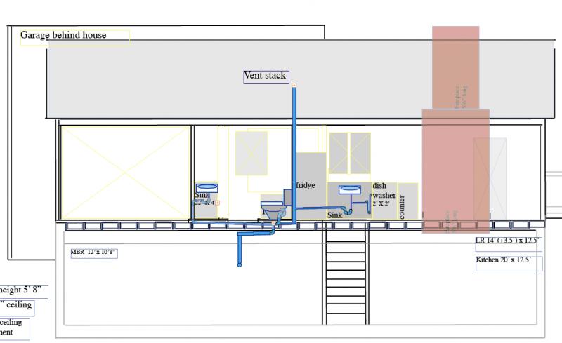

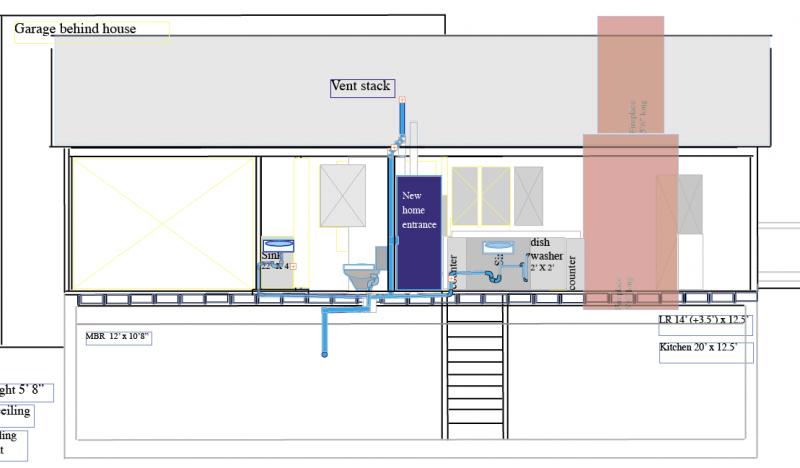

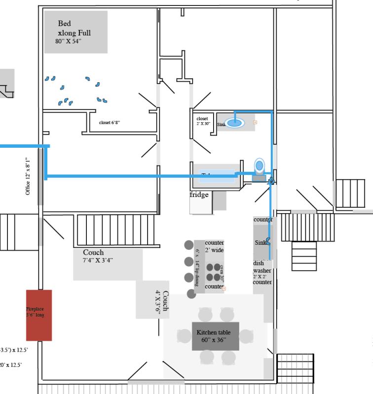

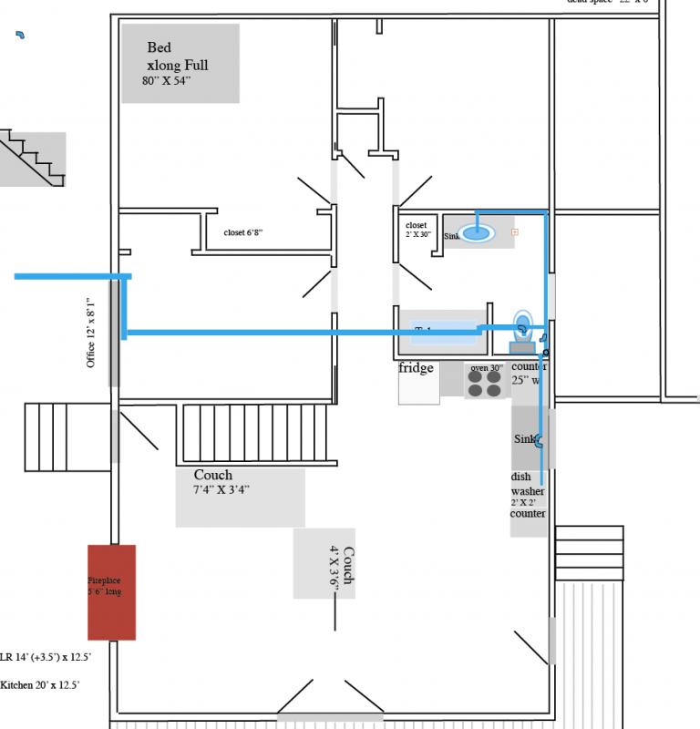

Have two views with existing plumbing as close as I can get it to accurate, and what I think I would like to try to do.
You can see on the ariel view, where I am looking to cut main entrance, a small future mudroom and off to the offscreen right where the garage is.
Thanks again guys and love the forum!
First picture of each pair is EXISTING plumbing.
second picture of each pair is PLANNED plumbing / idea.
Your drain line can't start down before the vent connection...
zx6e
NH
Not quite sure I get it.
So are you saying vent has to be highest spot in drain system?
And yet I have to have a vent near toilet before anything upstream?
So does that mean I need two vents?
The vent goes 'up' in the building, and above the floor level a foot or so I guess is where the kitchen sink must hit the vertical vent stack as is now (can't confirm without ripping out walls and cabinets, but that's where it would have to plug in).

We need to "see" the plumbing in the bathroom area. The rest of the house has nothing to do with your question. But, from your drawing, it appears that you are "moving" the wall under the right hand eave inward. If you have trusses, you can't do that, and it might even be inadvisable with a built up roof structure.
zx6e
NH
Thanks HJ:
So basically if I read your comment correctly, I might change what you said to "I'm moving the wall under the right hand eave 'upward' ". Does that make sense?
In the bottom two illustrations, essentially what I'd like to do is cut a new 32" door on the middle 'east' (the way drawing is oriented now in post, assuming 'up' equals 'north') wall and that would require me to move that inner bathroom wall 'north' in the picture about 8 - 10". My ridgeline in my roof runs 'north - south' orientation in the picture. As far as I knew the horizontal walls 'east-west' walls are non- load bearing, and it's the 'north-south' long lengthwise walls that would be all load bearing. I'd put in a 2x8 or 2x10 header over the door, and if need be brace up that wall area where the bath wall was moved.
Thanks!!
(In my very basic construction learning, I'd learned that the walls perpendicular to the roof ridgeline - at the apex of the trusses / high point of roof - were all non load bearing (these are parallel with the trusses), and walls following parallel to the ridgeline were all load bearing).
