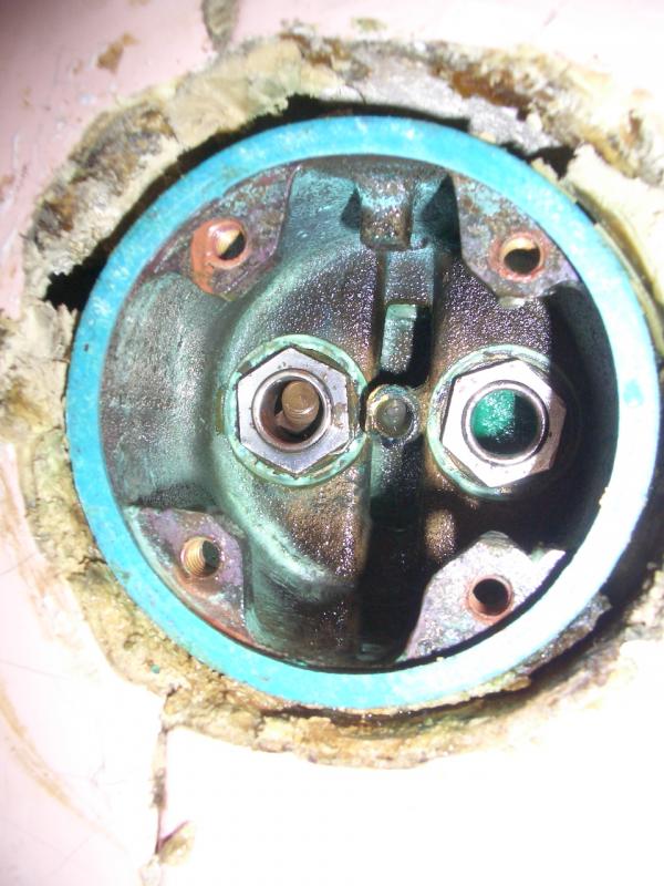

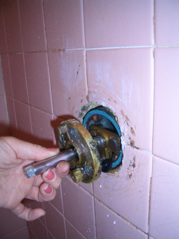

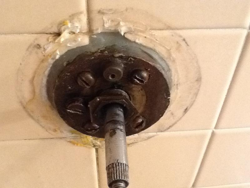

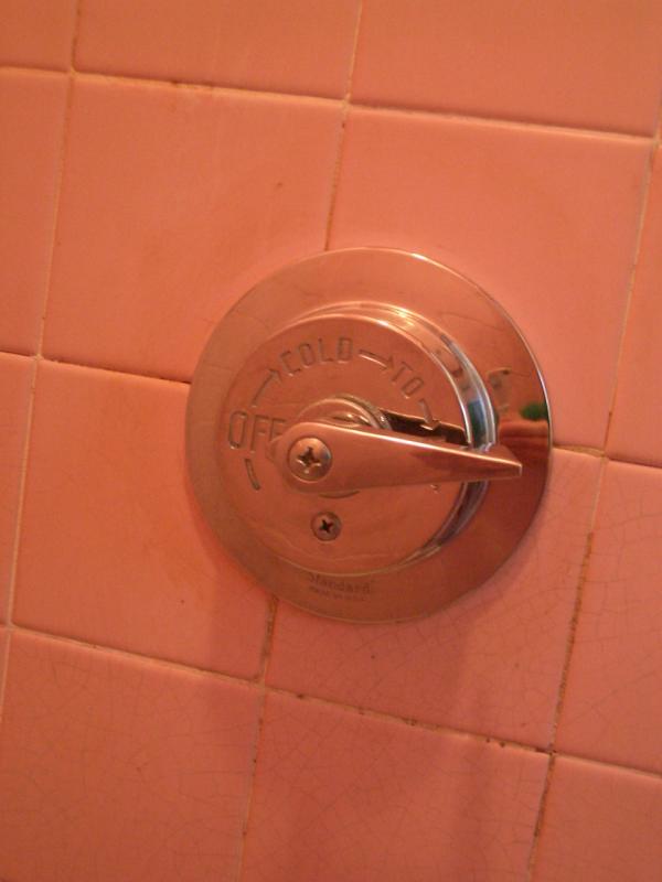

Shower has been dripping. The house was built in 1938 and renovated once in 1958. and this shower faucet is probably from 1938. The other shower's faucet is definitely from 1938 and I had to repair that in 2006, at which time I bought a rebuild kit for this one (FKAS 201-2). At the time I had found the faucet diagram online but now I cannot seem to find that old description and details. Too much more stuff has been added to the web, or perhaps the old info has been removed...
Anyway, I removed the handle and such to get to the point in the photos. There is no access panel to the pipes so removal of the entire assembly is not a viable option at this time.
I am in need of some instructions as to what the next steps to disassembly and repair are, but unable to find it on the web.... I did get the left screw and center flange and nut off so now there are just the two top and two bottom screws and the center valve to deal with.....
Addendum: The repair kit indicated it is for a B201/B202 however it is not... it is a common error it seems after talking to several supply house that they confuse the R1400 and the B200 with the B201/202. See links below for schematics

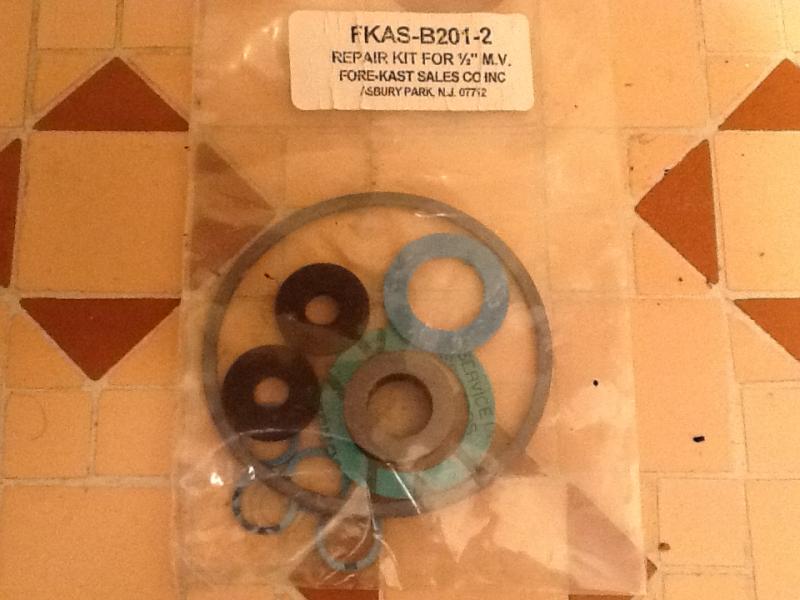

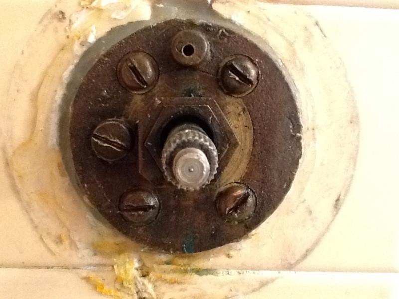

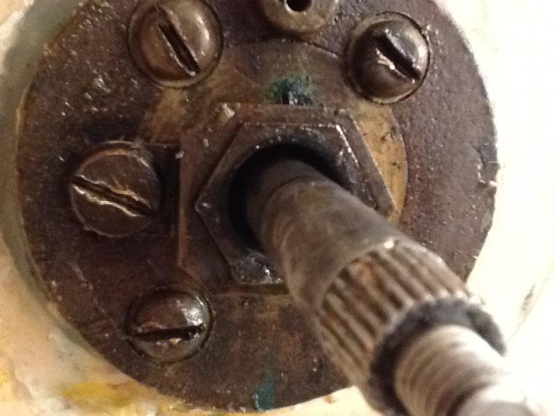

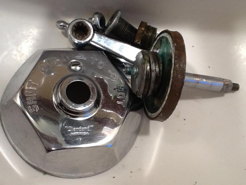

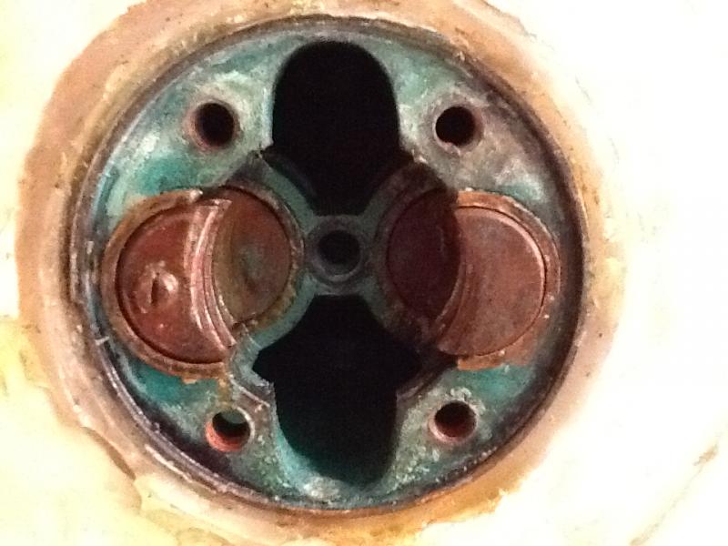

Okay, here is the latest, after soaking the screws with PB Blaster and using visegrip on a stubby fat slotted screwdriver, the brass cover came off.... unfortunately, the repair kit the plumbing supply house said was for this faucet doesn't look like it will suffice.... it may be the wrong kit.... you can see the chrome hexagonal cover in the one photo.....
Any guidance anyone?????
Addendum: I am still not sure from the diagram as to what the difference is between a B201 and a B202. As stated above, the repair kit was improper.

At this point I have closed it back up and am waiting, but I do want to note that the two sleeves have become frozen and will require some soaking with PB Blaster to free them up so I can replace the washers at the back of them. The two plungers came out readily from them, the hot plunger is on the left in the photo below and has a regulating screw in it - I have not touched the regulating screw so I am presuming that upon reassembly my mix of hot to cold should be as ideal as it was before.... the cold plunger is on the right side. If anyone has a spare of that particular cold plunger there is another forum member looking for that part - Bob Cleveland. Both Bob and Walter have provided advice as to freeing up the sleeves.
I will no doubt have more questions on re-assembly when the parts do arrive as I don't have any traces of the prior renewable pieces to just pop out and replace -- the prior repair was done by a silicone happy person who didn't bother to consider using parts I suppose. Only good thing is that as you can see in the photo, that person used a whole lot of silicone caulking in the wall around the outside of the faucet body, so when the cover plate came off absolutely no residual water infiltrated the wall..... while I am waiting for parts I will clean that out and fill it up again with silicone....

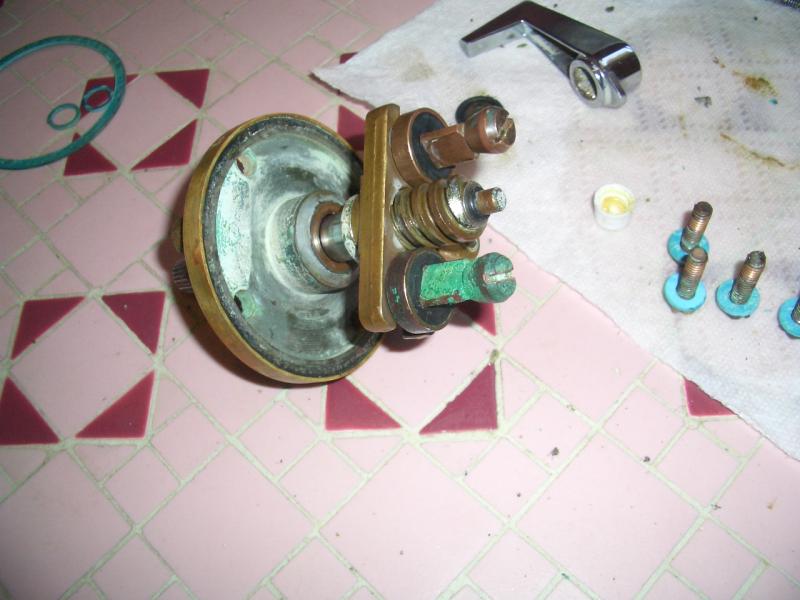

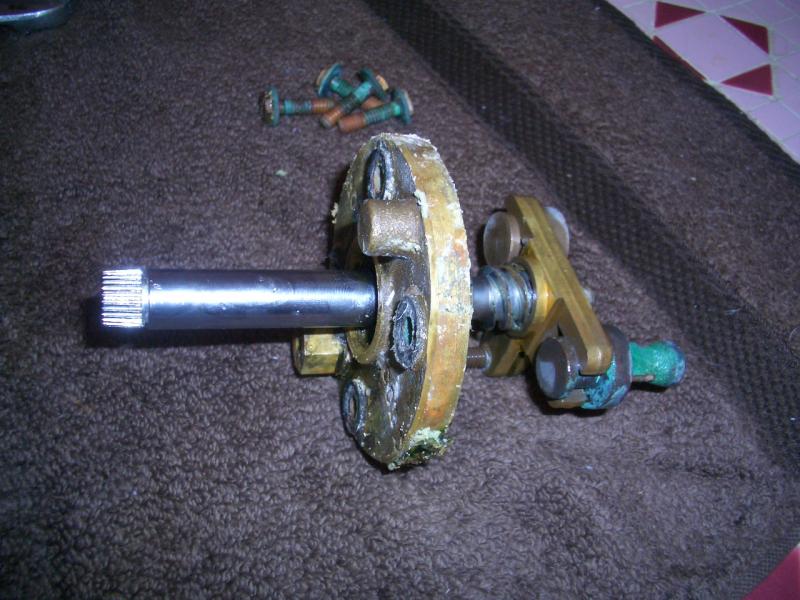

1938 American Standard shower faucet R1400 - other bath - repaired in 2006
As a comparison, here are photos of the shower faucet I repaired in June 2006. It is an American Standard, single handle faucet R1400 model made from 1928 until 1970. The repair kit was FKAS-R1400A and cost me $10.39. This may prove useful for someone someday.... The repair was easy.
